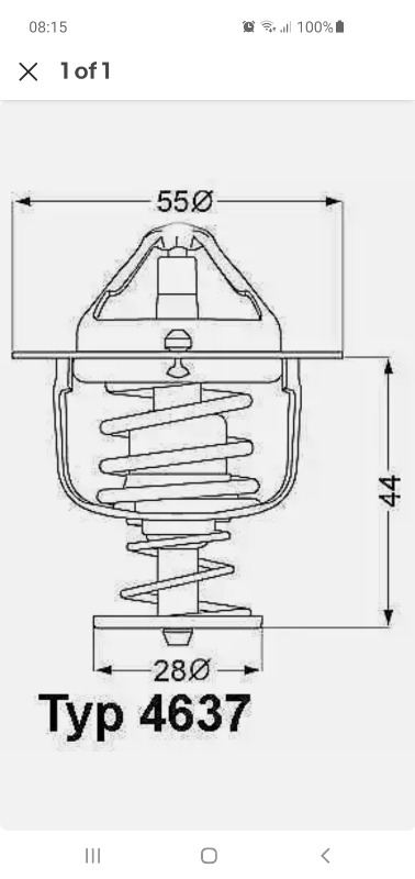

It would be useful if you could accurately measure the new stat when it arrives and post the dimensions in a post on here. I can't help but think Kawasaki didn't use a readily available automotive stat, from say a Mitsubishi or similar. If the alternative type can be identified it could be very useful.

Stiggy wrote: It would be useful if you could accurately measure the new stat when it arrives and post the dimensions in a post on here. I can't help but think kawasaki didn't use a readily available automotive stat, from say a mitsubishi or similar. If the alternative type an be identified it could be very useful.
Perhaps.. but how to measure closed vs open dimensions? Let me think on this...

I was thinking of dimensions like these with possibly the addition of a fully open length.... in boiling water measure with calipers.
This is just a random ebay example NOT a z1300 one !!
