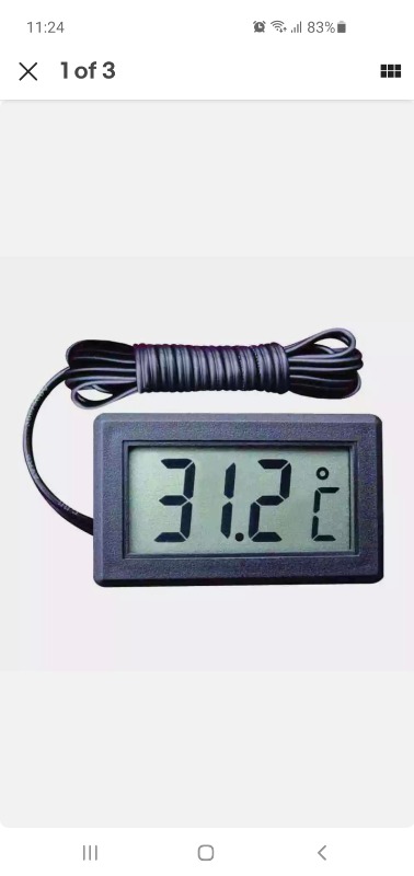

I haven't had cooling issues but I temporarily fitted a cheap digital temperature indicator as a cross check. They are cheap but accurate enough for this purpose. Lots on fleabay. They have internal battery so no wiring needed.
Here's the item number of the one I got. 274386235926. Beware some similar looking only go to 70 deg c.
Most i ever saw was 89 deg c in traffic but usually about 86 at mach 1.
Note... mine is a UK ZG1300 DFI.
I used a blob of silicone sealant to attach the sensor to the coolant outlet, then added a piece of insulation about 2 x 2 inches to prevent any false reading due to air cooling.

5 years 9 months ago - 5 years 9 months agoStiggy wrote: I haven't had cooling issues but I temporarily fitted a cheap digital temperature indicator as a cross check. They are cheap but accurate enough for this purpose. Lots of fleabay. They have internal battery so no wiring needed.
I have an Acewell aftermarket speedo / tacho unit on my ZG, the coolant temp sensor scews into the same place as the original temp gauge sender, the display is in degrees C, I get pretty much the same readings. The fan comes on at 87.

5 years 9 months agoStiggy wrote: I used a blob of silicone sealant to attach the sensor to the coolant outlet, then added a piece of insulation about 2 x 2 inches to prevent any false reading due to air cooling
Are you just attaching it to outside of aluminium housing or hose or somehow into coolant liquid?

Just to the outside... hence the insulation to prevent air cooling of the sensor. It was in close proximity to the coolant outlet connection on the engine.
