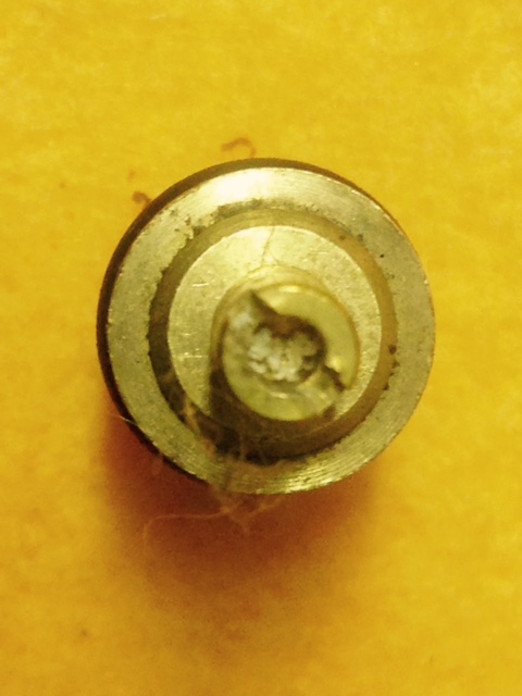

I have stripped the carbs again and found two other problems.
1/ I used instant gasket to seal the air box, this was supposed to be oil and petrol resistant - it is not has I found that it dissolves in petrol and gets pulled into the carb. Had the float closed off the petrol supply this might not have happened but I thought for warned is for armed for other members.
2/ The carbs were perfectly clean after the recent strip down but when I stripped it today I found the jets in the pictures totally blocked, I used new rebuild kits but this looks like it has been there months ?
I am trying to figure a way to get a fuel filter in line but I struggle to see where one could be fitted - any clues would be appreciated.
