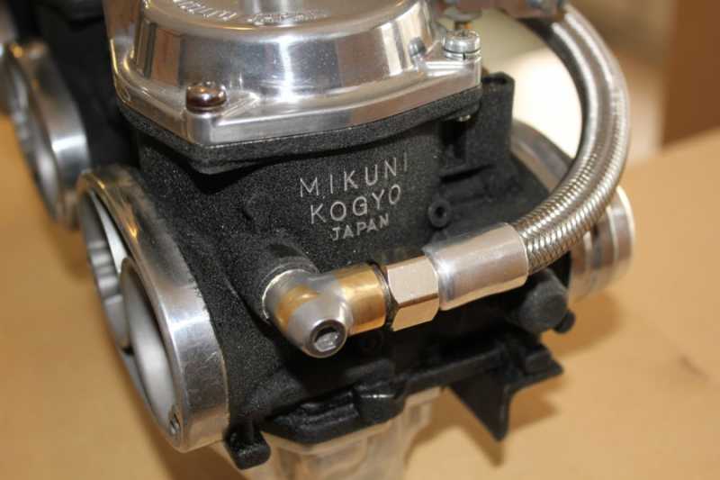

Re. your query about where to fit an inline fuel-filter: That's the best question you could have asked at this point. Do yourself the biggest favor you could bestow upon yourself and give some serious thought to taking your "Right-side" carb to someone competent and have them "Tap" a 1/4" pipe-thread into the outside blank "fuel-boss" and do a simple, effective and efficient Fuel-line routing conversion. It'll be easy for anyone with some real experience with "taps and dies" and the minimal cost to have this done (should take 30 minutes or less) will be worth it. The 90 degree fitting is readily available, easy to assemble and I guarantee that you'll wish you'd done this at the very beginning of ownership. You do not need to have a coupling at the 90 degree fitting as I did. The fitting can be a simple 1/4"MPT X 1/4" brass barb; meaning the fitting will thread into the carb. and the fuel line can slipped directly onto the "90" barbed-end and be secured with a clamp. The stock "fuel-Tee" between the left and center carb. is simply "capped." Now would be the opportune time to accomplish this while the carbs are off and apart. That fuel-boss will need to be drilled-thru to get the fuel into the fuel delivery gallery. This part is best done on a drill press so if you do not have one or are not comfortable doing this you can probably get it done when the threading is taking place.
You'll not regret this mod.
