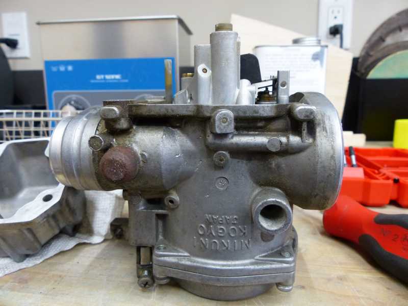

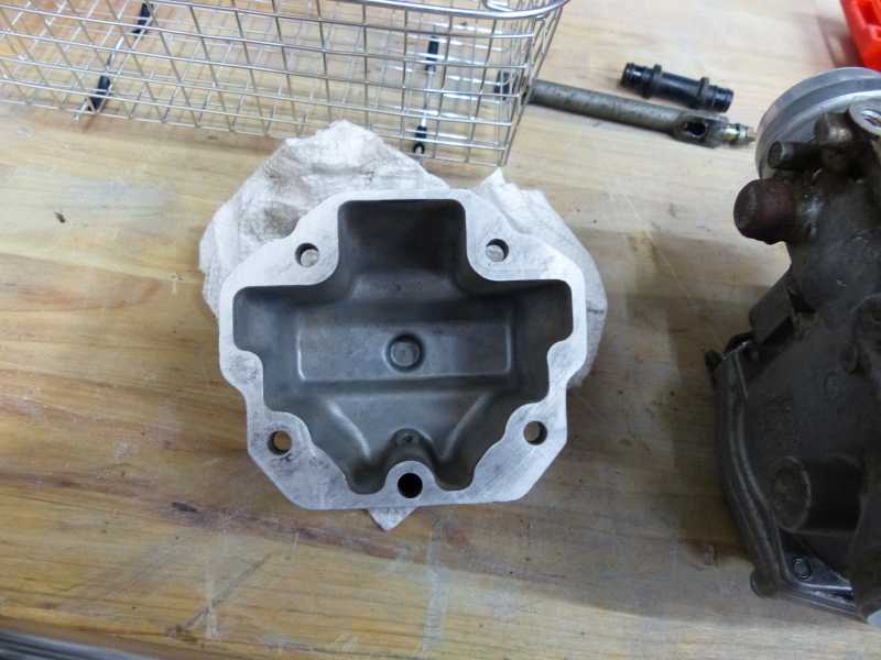

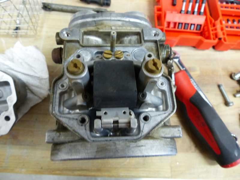

Coincidentally, I just happened to get in to my carbs today. Pulled off the 5-6 carb and popped off the float bowl. It was so clean inside I thought it was new. Maybe not so bad after all.
First thought was I'll run them through my ultrasonic cleaner anyways. I got them apart so why not. Only two passages in the float bowl. Did a quick blow through with the air gun and who'd a guessed the passage in the bottom of the bowl which feeds gas to the enrichment jet tube is blocked. How could a carb that clean have a blocked passage?
Also note the oxide on the enrichment jet tube
Quick look at the float level and it's obviously set too high.
So this is my basket case I'm working on and if this is the kind of work the previous owner has been doing, then I've got my work cut out for me.

kawboy wrote: <" Did a quick blow through with the air gun and who'd a guessed the passage in the bottom of the bowl which feeds gas to the enrichment jet tube is blocked. How could a carb that clean have a blocked passage?">
Thanks for these photos and comments. You have in so few words validated the entire point of my ranting on & on & on & on & on & on..... about why these carbs can give so many owners....seizures! And for clarity; that's the "choke supply tube" you're referring too. I prefer to keep the word"enrichment" strictly for the enrichment valve ( the assembly under the small aluminum cover on the left side of each carb.
So, Now you can see how a tiny gallery and the metered .025" "transition-ports" can remain plugged.
Strip the 3 carbs down to the throttle-plates and shafts (DON'T TOUCH THESE !) and soak them 1 at a time and fully submerged in a pot of Lacquer thinner for 24 hours. Flip the bodies around initially to burp the air out. 6 hours soaking on the air-filter end, the cyl-head end, the diaphragm end and and finally sitting on the float-towers. The bodies need to be fully submerged !
IMPORTANT: Before blowing out with compressed air ensure the metering jet in the choke pickup tube is secure! I have found these to be loose and have had them blow out. PITA
If it's loose, look for a crack running up the side of the tube. It's easily repaired with some careful soldering.
Use the appropriate cautions with the highly flammable lacquer thinner !
THEN: The VERY FIRST attempt to blow out with comp.-air should be from the inside of the venturi with the throttle plate open just enough to expose the transition ports. This will blow back debris from these tiny ports so it can come out of the other (larger) end of the open galleries.
Then systematically blow out the rest and repeat with #2 & #3 body. You can soak all 3 at once if you can justify the cost of the thinner required to fill a vessel large enough for the task. When you're done: use a syringe to flow-check the idle-air and transition ports. The rest has been documented in detail elsewhere.
The "oxide" on the choke pick-up is likely due to contact with water !!!!
Do not judge the float level by the photo. Wet level setting only !
The aluminum, throttle-rods ( I see one in your photo) have a very small piece in the end opposite the adjuster. Be careful not to have this drop out! Study a parts exploded view for this part and the other pieces plus a spring and the specific way they assemble. Google: "Kawasaki Motorcycle Parts 1980 KZ1300-A2 CARBURETOR ASSY Diagram"
