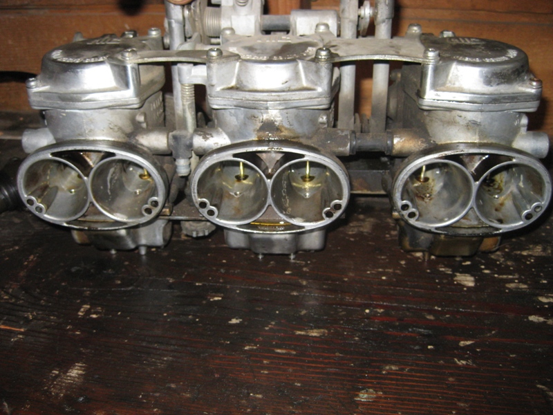

Using an ultrasonic cleaner is by far the easiest method. I did mine in a bath with "purple power" degreaser. Similar to simple green but not as caustic on aluminum and brass.
Before:
After disassembly and a dip in the cleaner for a couple hours.
I bought a used ultrasonic unit off of eBay for around $30, but the shipping cost close to $70 because of its weight. Even the cheap Chinese ones can do wonders. You don't have to buy special solution, any number of common cleaning chemicals work.
Before:

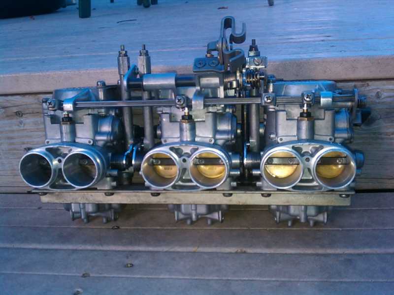

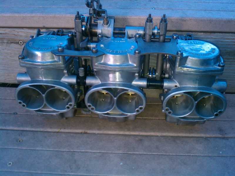

Yes, I had the parts yellow passivated. Finishes them off beautifully.

Yes that's it guys vapour blasting, O-rings not in yet Kawaboy been getting everything re zinced to make them look pretty
