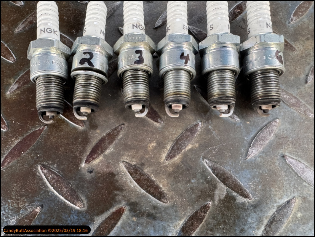

Running a tad lean across the range. Thinking of up sizing main jet from 110 to 115 or 120.Thoughts? 115 or jump to 120?

1 year 3 months agoBike is running lean just off idle circuit all the way to main jet. Main jet is *real* lean, so my thought was to fatten the main, which would also fatten from 1/8th throttle to full?Try raising the Needle 1 slot !
I don't know how significant a 5 pt jump is for main jet, hence the question.

I'm running a DG-6 into 1 exhaust with CermaChrome headers and K&N filter. Elevation is 0 feet to 1,200 most of the time at 800 or so.
I have 4 more racks to go through, once they are done it will be easy to swap and test on my test road.
Oh, used a ColorTune or whatever they are called to adjust idle mixture. Except for carb 1 which still doesn't show any response to idle circuit adjustments.
