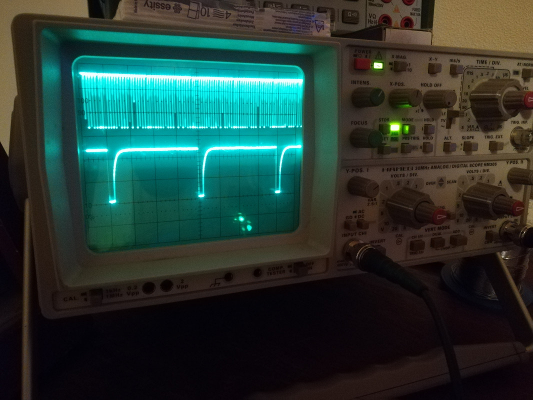

Yes on wooden board is much easier to put everything together. Ill be making still alot of changes so its practical like this. I got brushless motor from modell plane with controller to turn thoes pseudo trigger wheels and see how angle changes in tuner studio are affecting the ignition timing and also im able to stimulate lambda value and temperature of coolant and iat, as well as engine speed ant tps position all calibrated in the software.

Hier photos of the signal I manage to generate for 10 euro.

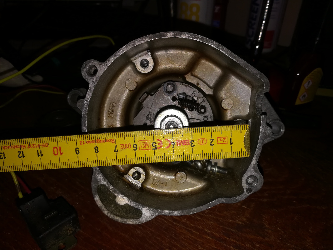

Hi, so there is a lot of space in the distributor for 24 or even 36 teeth wheel and sensor. The question is, reluctor or maybe better hall sensor?
I see in the engines I disassembled mostly reluctor sensors for reading crank speed. The input signal to ecu can be internally selected in the ecu to either, and have pull down resistor engaged. I'm planing on batch injection due to possible limitation of the injector duty cycle, but I have to verify this one yet (don't know how much current is necesery for hold, in peak and hold sequence). So reluctor or hall sensor, any pro – contra to either of them?
