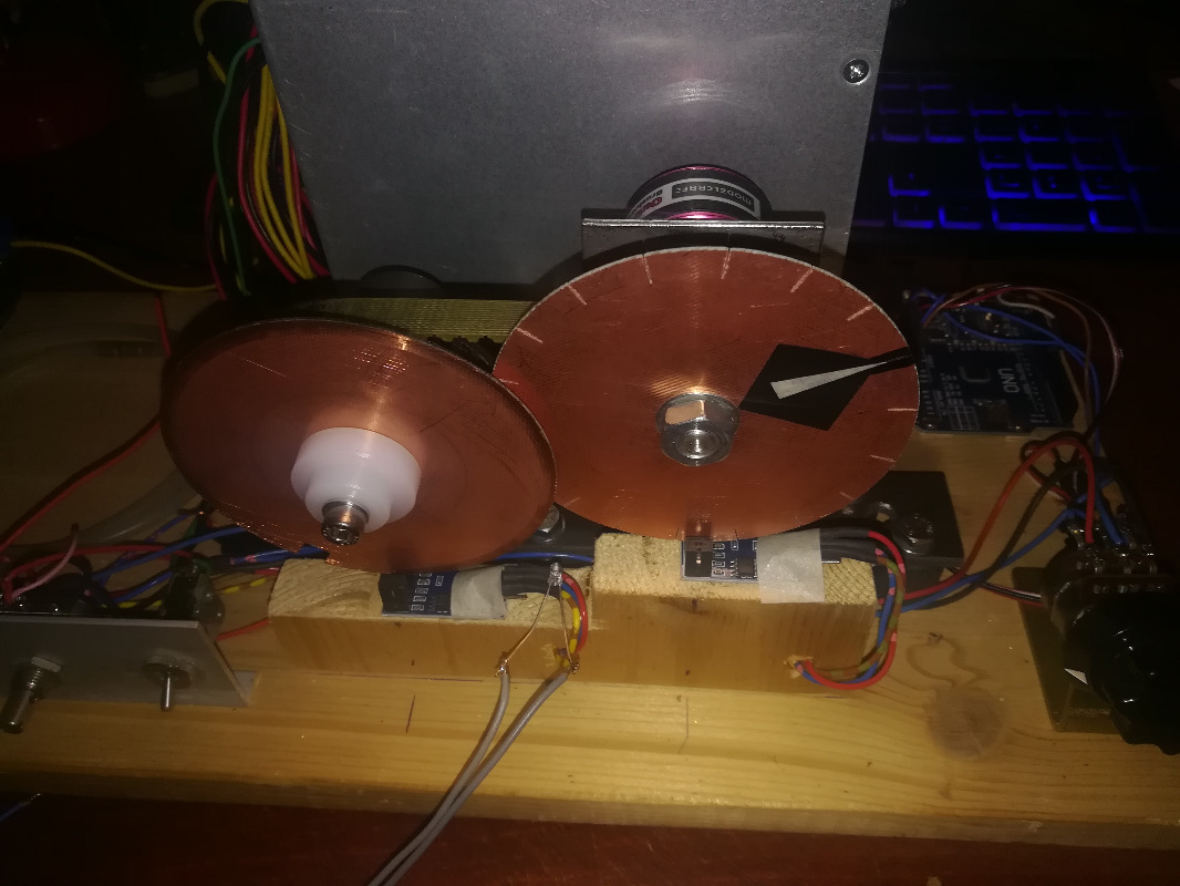

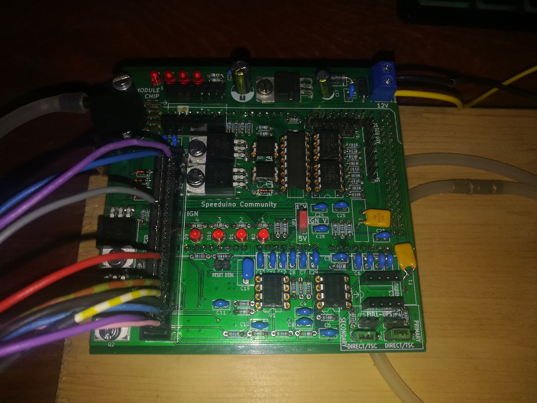

Till now I have build simple setup made out of speeduino board and optical sensors, just to test how angle of trigger works and some simple ecu programing stuff with tuner studio. I'm going to post picture later. Also having trigger wheel with only 18 teeth gives only resolution of 20 degrees! Thats weak? I thing?

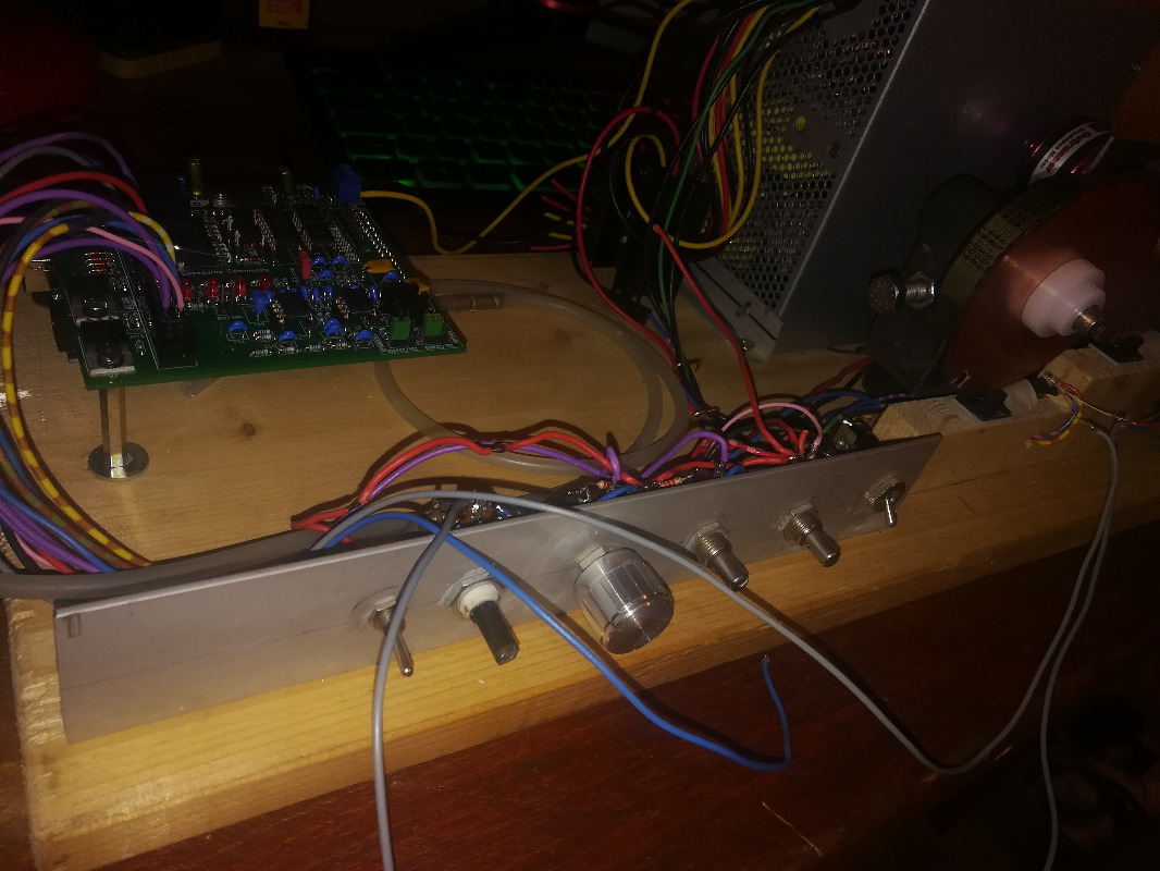

That's good news Kawboy. It will give me 10 degrees per tooth. Enough to run waste spark and hopefully injection. Ill probably need one more sensor on camshaft for sequential injection but have to see to that first. I already have throttle body with original injectors and would like to use them. Don't know the flow rate but it can be determined by comparison to known injector. The reason for emu 8 is that it has a lo z injector driver built in, peak and hold and can drive ignition coils also directly with no extra electronics necessary. I think otherwise rf from spark plug cables could be problem later with alot of hardware here and there because ther is not so much space to mount everything away from theme. It cost here 1600 euro so I could live with that also.
Hier some pictures of speeduino and some simple trigger setup for two trigger sensors.
Greetings
Greetings

Breadboarding at it's finest!
I'll need to read this thread several times...
to better understand.
