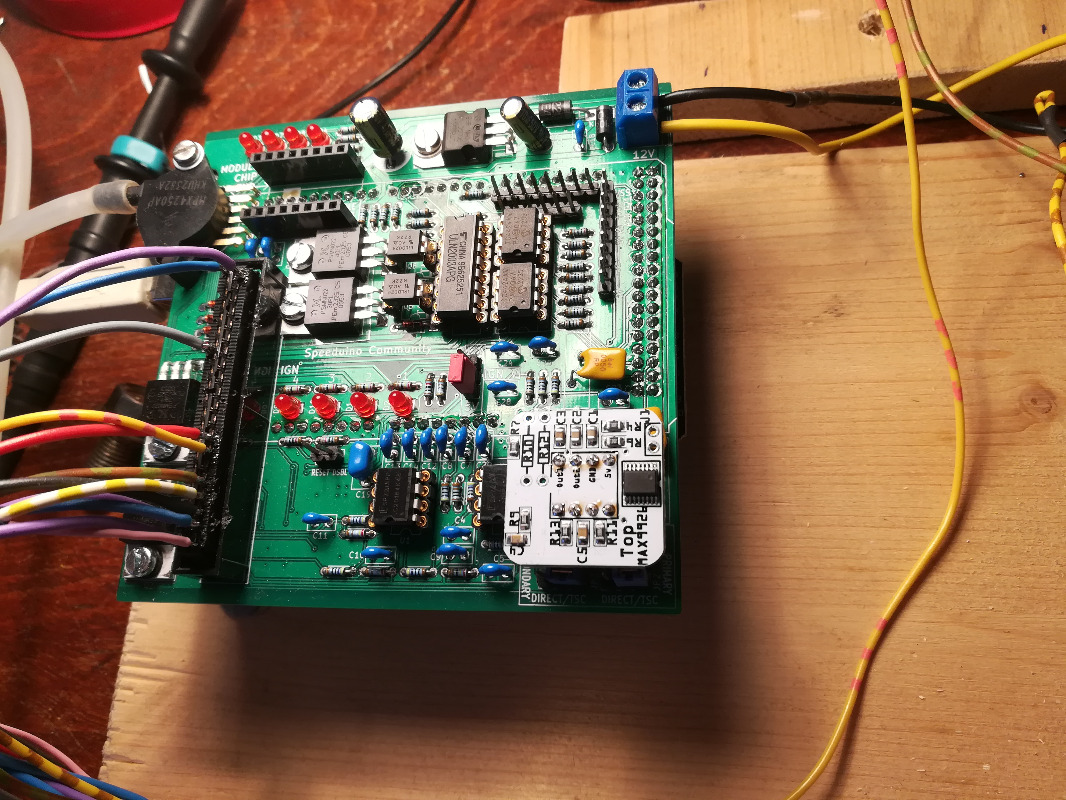

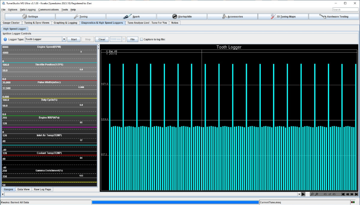

So, MAX9926 conditioner have arrived. I also made the VR sensor adapter plate. And some pictures of signal logging through tuner studio.

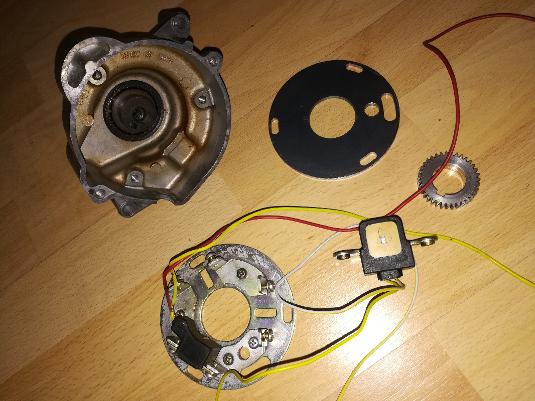

I got some voltage reluctors from different bikes but still they wont feet in the distributor.

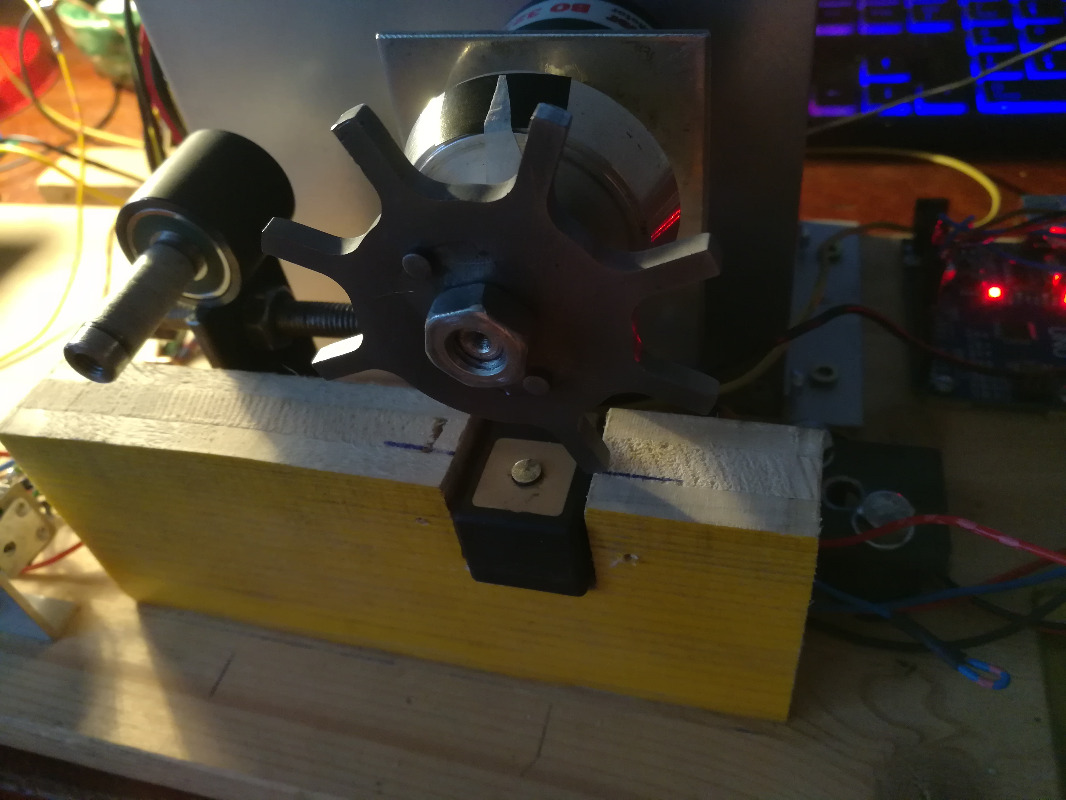

next trying different trigger wheels.
