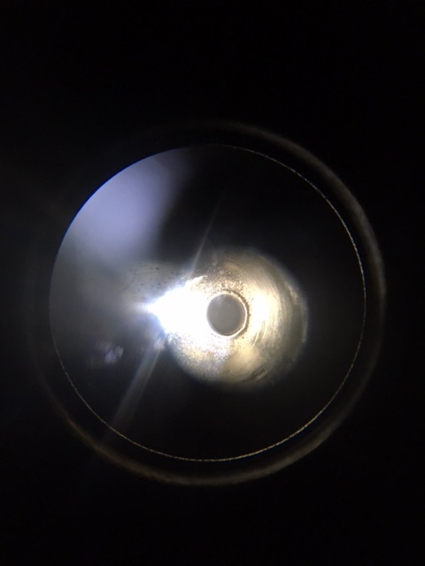

The orifice is factory milled and reamed to guarantee a very specific flow pattern and should be shiny smooth.

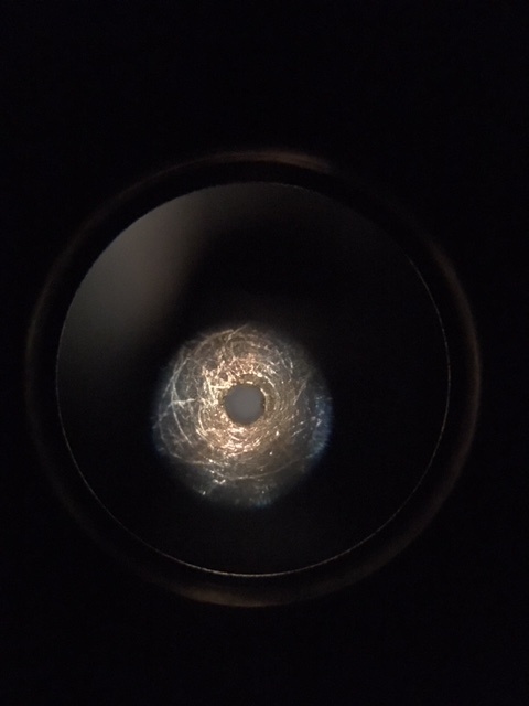

Sticking a piece of wire into it and twisting:
The end of a piece of wire will gouge and lift material that with totally screw-up the flow pattern.
You have to look closely but the jet material has been shaved and lifted.

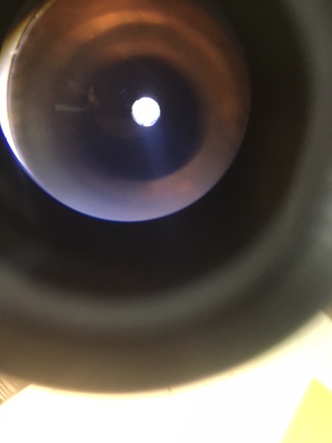

This is the end of one of those "Jet Cleaners" Same results as a random piece of wire cut with typical wire cutters
The end-burr will destroy the jets characteristics.

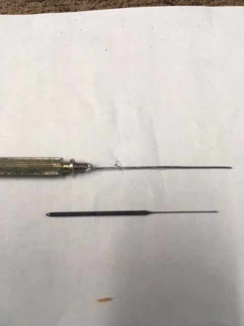

A couple of very fine Gas appliance pilot-jet reamers.
The solution: 6 new jets !

Long story short; If you want to render these jets totally useless go ahead and poke some piece of wire through it. Those “Jet Cleaners” ……..nothing more than Oxy/Acy tip cleaners – just as bad.
If you have to clean debris from a jet and lacquer thinner and compressed air won’t do the job buy some propane/natural gas pilot jet reamers and do it right. Or….just replace them with new jets.

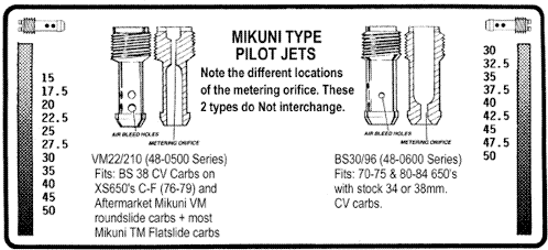

Just throwing this pic in here as an example. The entrance and exit angles of the jets are just as critical as the size of the jet. Change those angles and turbulance will cause the jets to not flow properly.

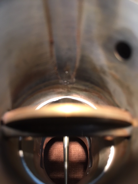

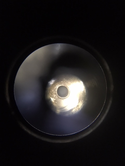

A good spray pattern
A spray pattern being affected by a disrupted flow

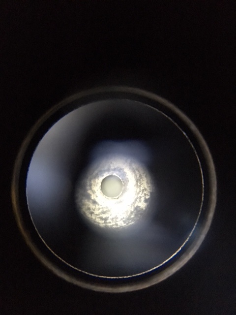

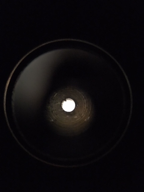

Better pictures of how little it takes to make getting a decent idle, impossible.
Same jet refocused (very narrow depth of field) to another area

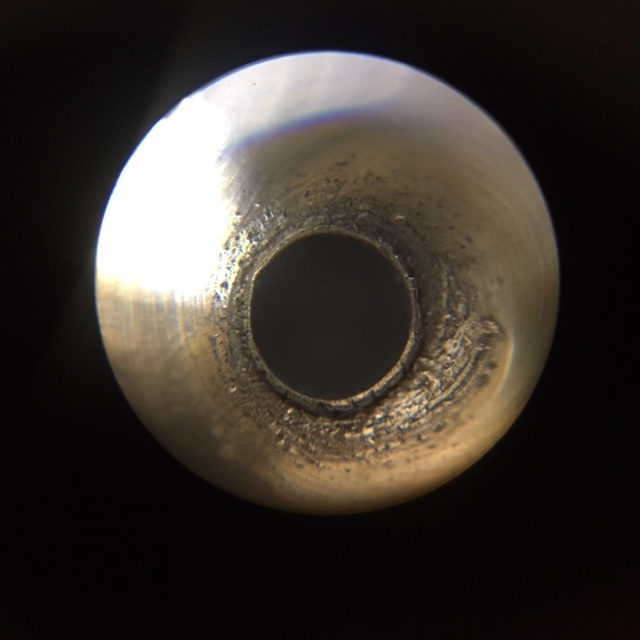

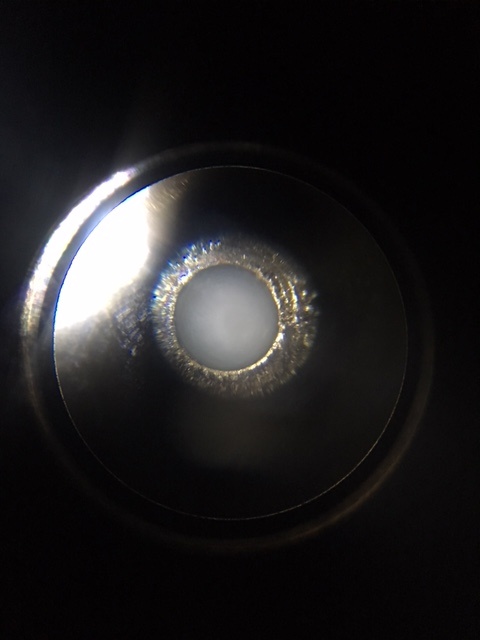

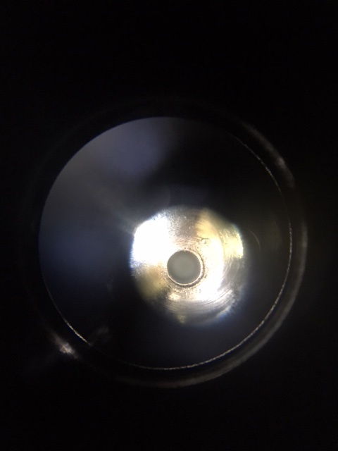

With some better lighting I discovered these jets had more problems then just being "burred" in the orifice. Some serious erosion/corrosion that likely had as much of a detrimental affect. All contributing to flow degradation. This damage was hidden by the fuel residue and natural Patina. Damage was identical on the inlet and outlet sides.
