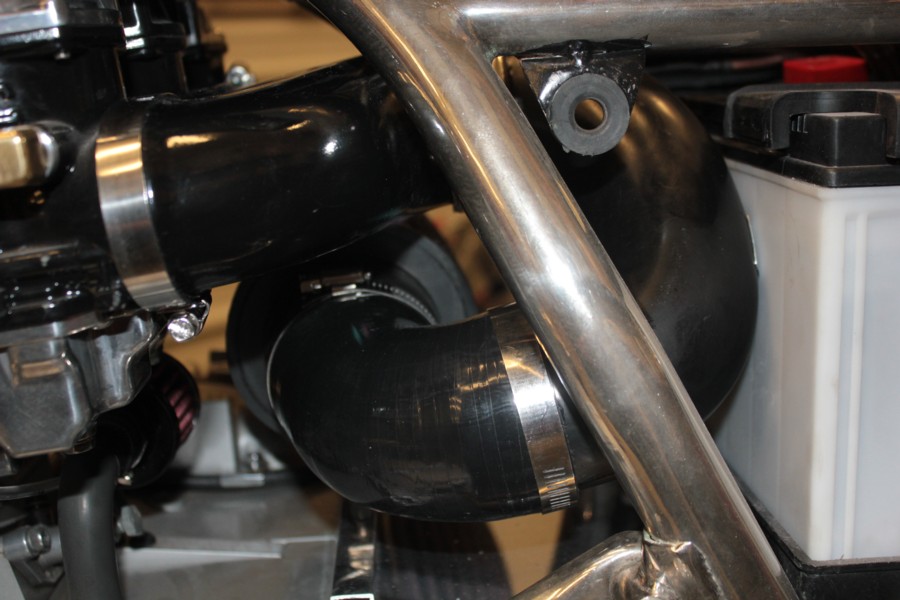

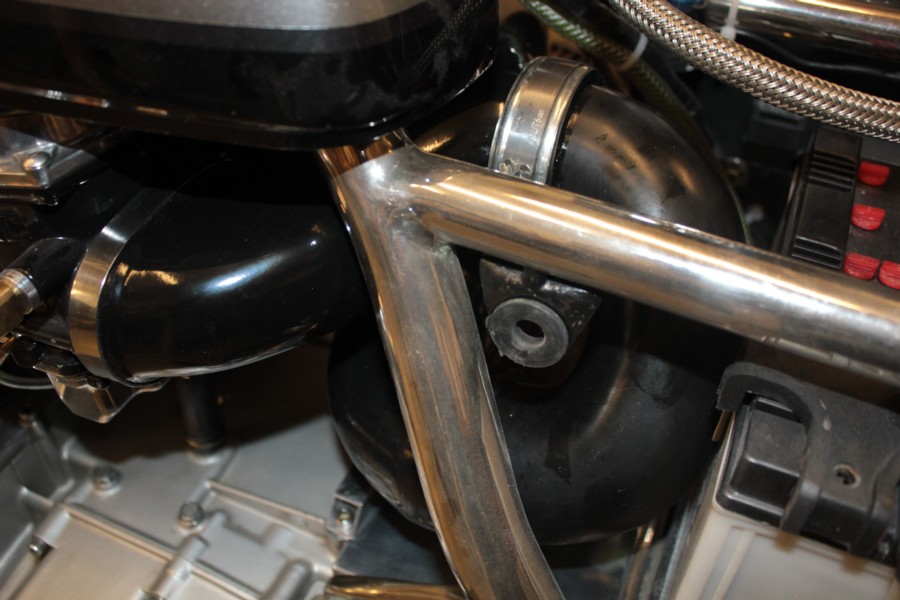

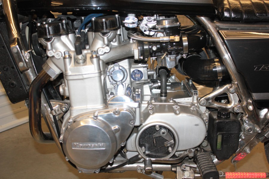

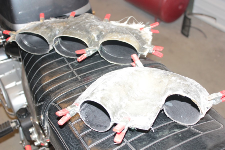

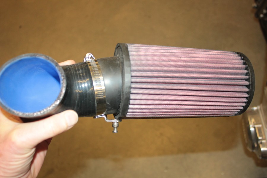

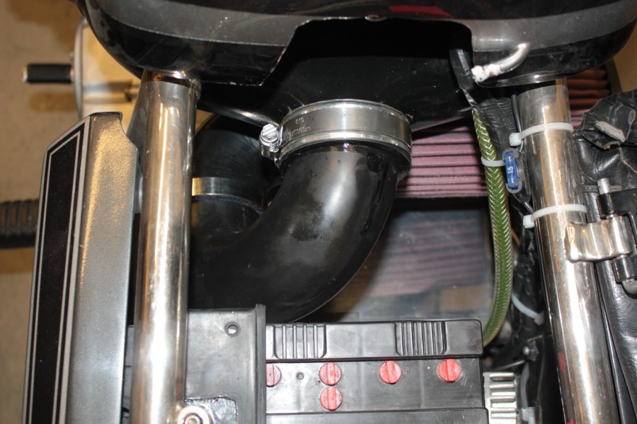

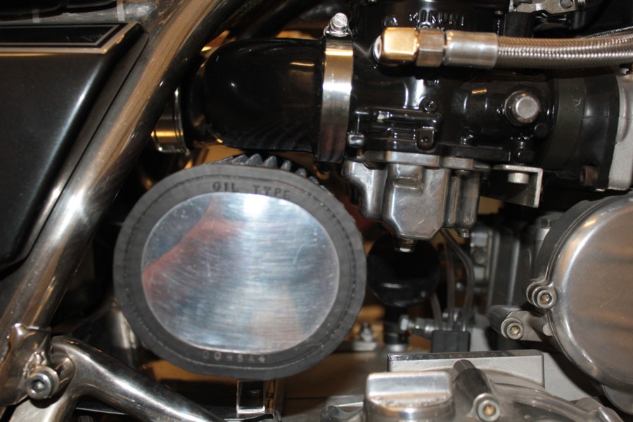

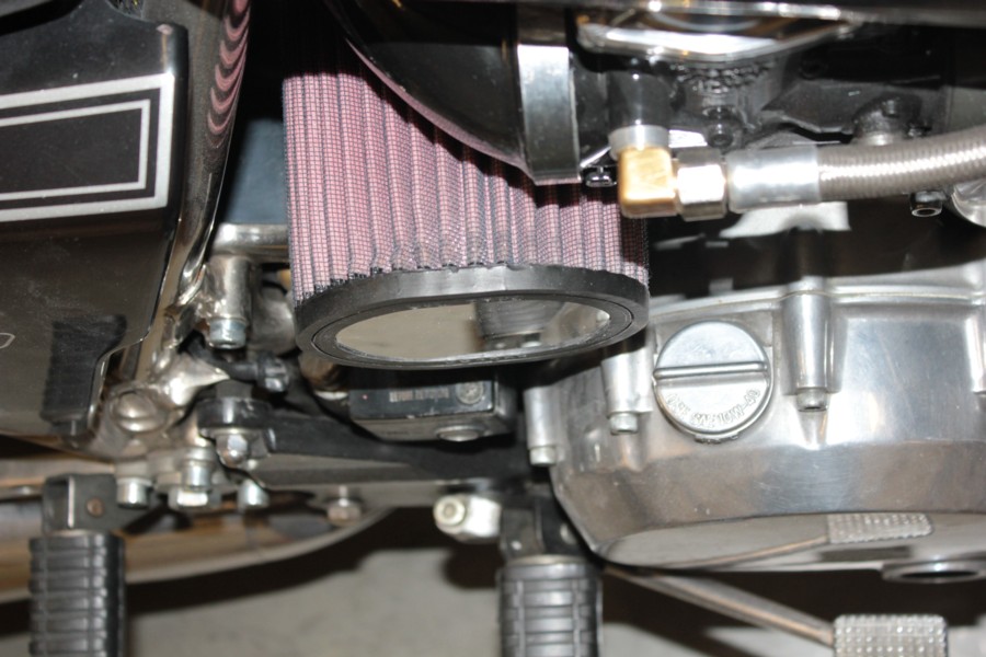

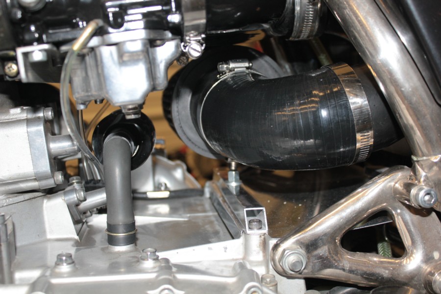

K&N with 2.5" fiber-glass intake tube and Plenum. Spent far too much time on this but the results are worth the effort. Started with foam plugs shaped to fit exactly, then laid up gel and glass cloth to produce the two, two-piece molds for each piece. The most difficult aspect now is cleaning the shop and bike. Fiber-glass dust is everywhere !

Very nice :)
Is that a chrome frame or just polished steel?

Nickel-plated !

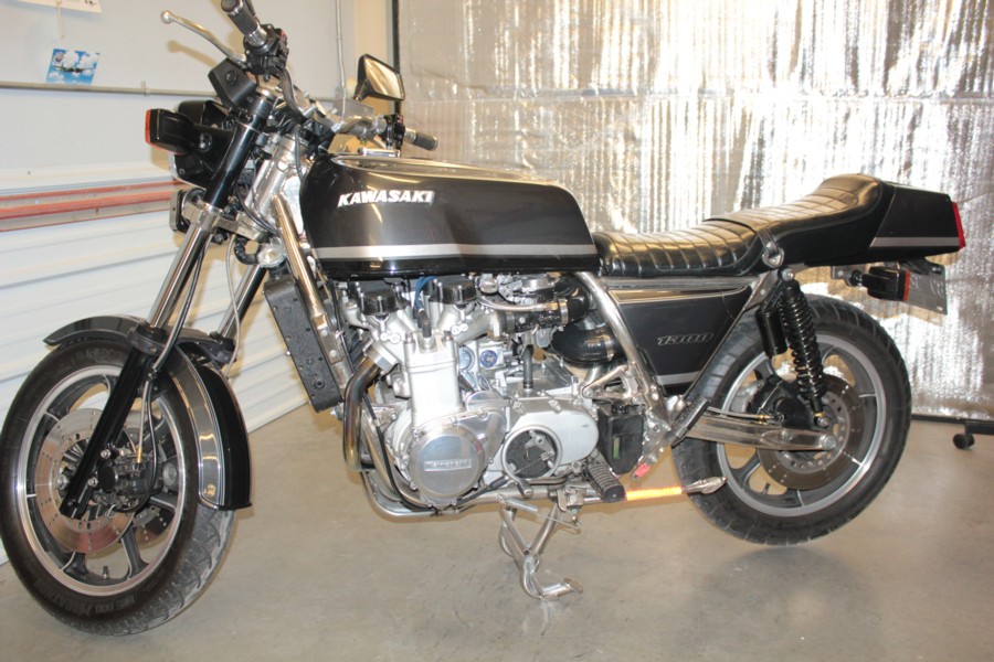

wow very nice, truley custom fabrication, and nice frame too, like to see a pic of the whole bike.. keep up the good work.

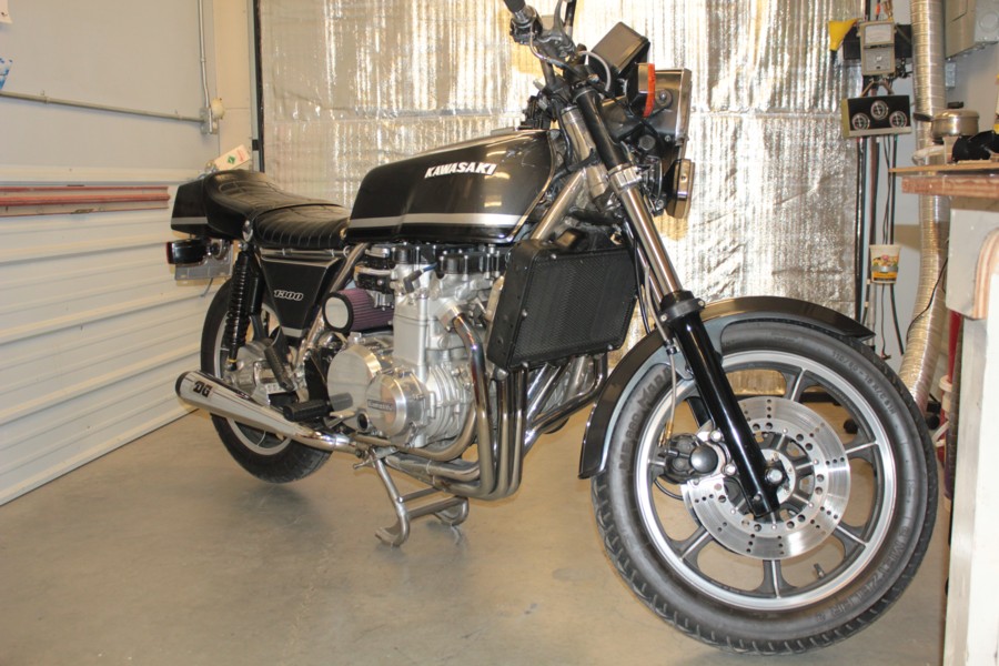

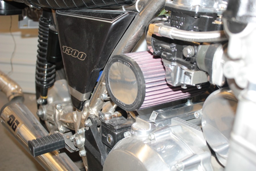

Ready for a new season !

wow, really like the look of that bike, nicely done , that intake is true fabrication art.. it should be in the rotation of the front page of the website.
