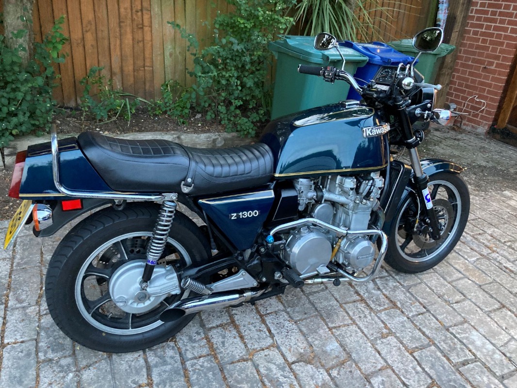

Hi Guy's just having a go at posting pictures. Well here goes,
Owned her for about ten years now. had some great times. but most of that time big fueling issues !!!!
But I've been of late having a good think about my problem. So come up with a few ideas. Consisting of a fuel pump in place of the solenoid, a fuel regulator in line. with adjustable pressure.
So more photos to follow, and would be interested by your thoughts.
Regards Phil

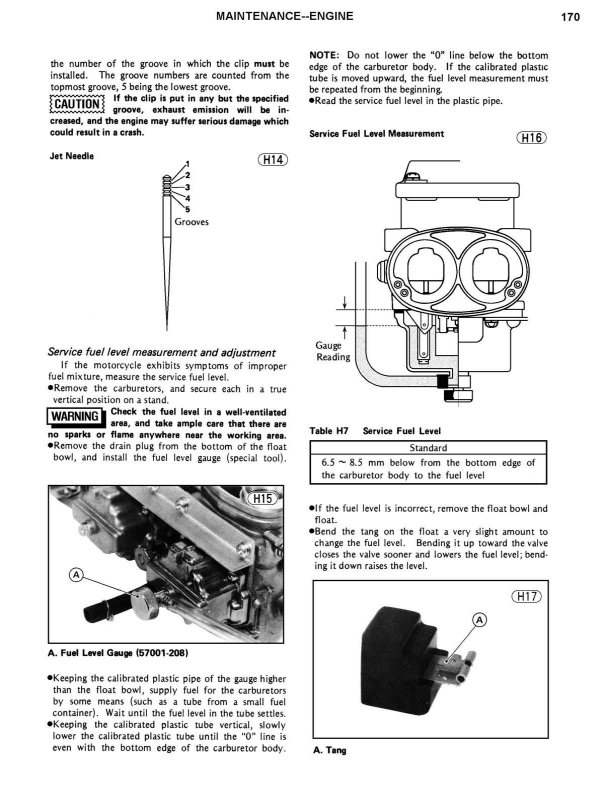

The reference for setting the float height is a little difficult to find. There's a section on rebuilding the carbs starting on pg 49 and that section refers to pg 170 for setting the "Service Fuel Measurement"

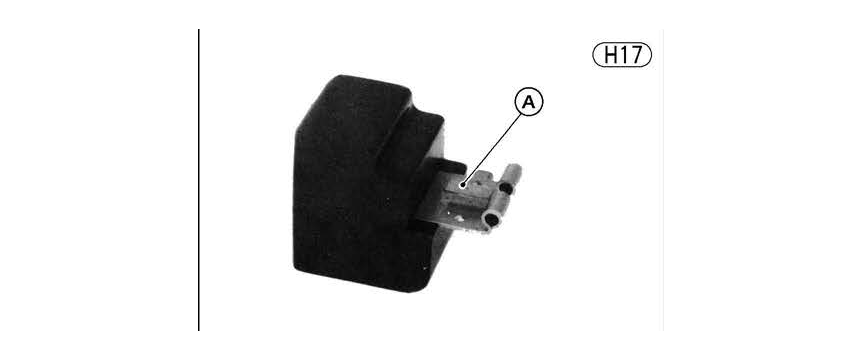

Included is a pic of the float. Note the vertical rise and horizontal tab. I've seen tabs manipulated so bad that the tang no longer looks anything like the original. I'm going to suggest that if one finds it necessary to adjust the float tang radically, then the likely cause is that the Nitrophyl float has become saturated with fuel and no longer floats at the proper height. hence the reason Scotch started building "brass Floats" and making them available on our site.

Kawboy, that's great info, I had no idea you could buy them on this site. The original float here the tang is looking very flat compared to the ones I have.
