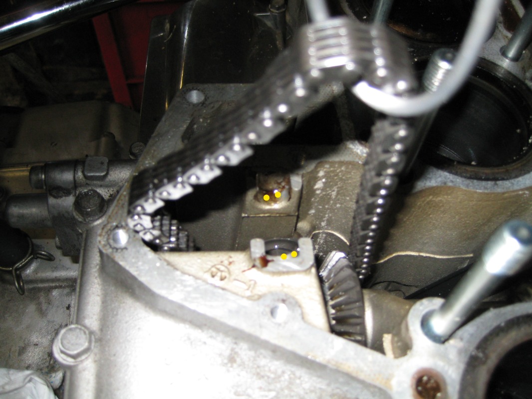

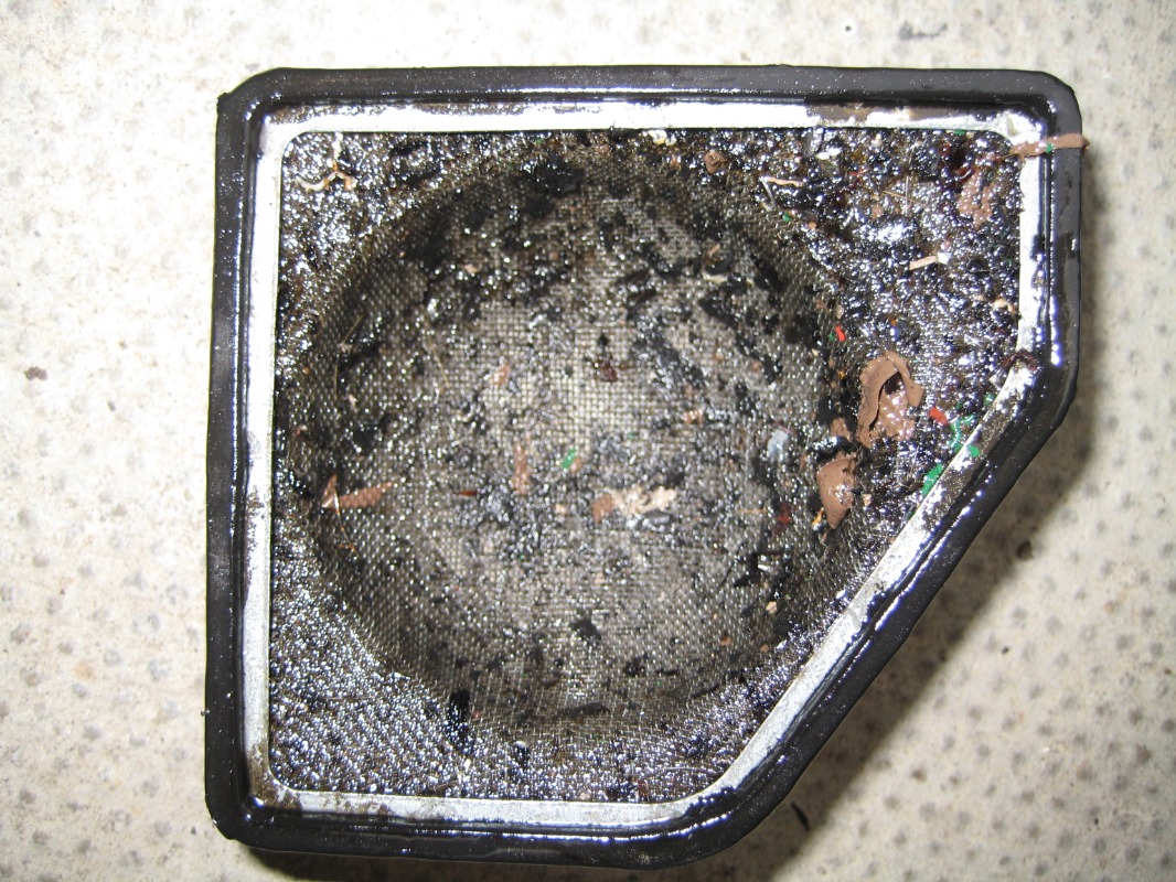

The work on my 13 is progressing, all be it slowly. I stupidly dropped one of the small rubber pallets that sit on the tensioner shaft, and it disappeared down into the deapths of the engine. They sat in the recess marked with yellow dots in the photo.This necessitated in me having to drop the sump, and all the extra work that entails. Stupidity definitely has a price. I eventually did find it, and I also found a partially clogged mesh screen, so the extra work wasn’t a complete waste of time. I was surprised by how much dirt there was caught up in the mesh. I am getting there.

Some things happen for a reason so count your blessings here. That screen looks to be 40% blocked. Yikes !! I also like to "analyze" the crud to understand what's contaminating the oil. Looks like a couple of pieces of silicone gasket maker (the beige colored items) The red and green pieces are interesting. ??? The black looks carbon like but maybe not???
Another good opportunity now to check your primary and secondary drive chains for wear. (slack)

The red and green pieces look like bits of old gasket sealant, strangely the black stuff is bit of leaves, as in off a tree. There also seemed to be a lot of fibers in there which looked a bit like animal hair. The only explanation I can think of is that someone in the dim and distant past has filled it up with old contaminated oil. I have now removed the valves, and some of them took quite a bit of pressure before they popped off the spring retainer. I don’t think I would have managed without a valve spring compressor. The old valve stem oil seals looked in pretty bad shape, one of them wasn’t even there. Took the springs out and there was no oil seal to be seen, no wonder the poor old thing burned oil.
