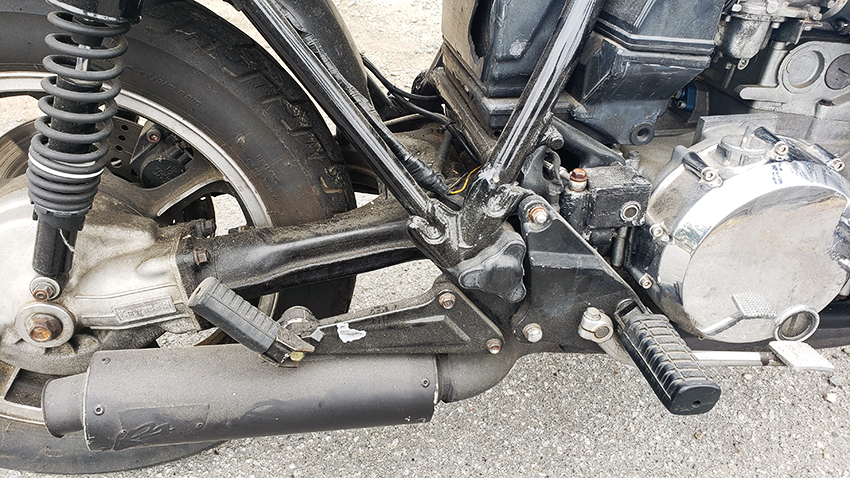

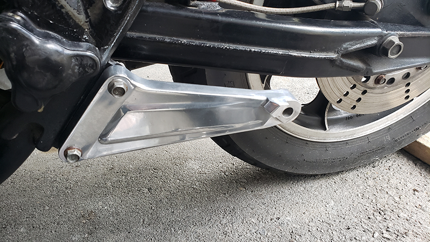

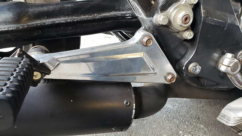

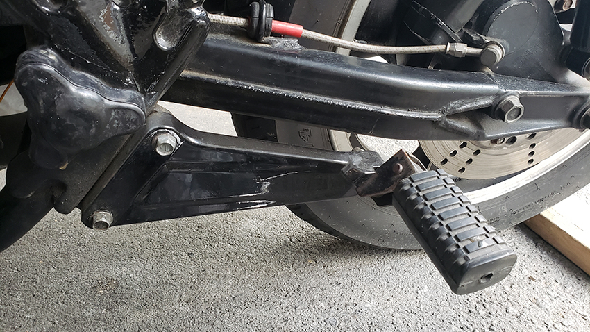

From the ready to go parts - already polished passenger footrest brackets! The bike already starting to look better. I didn't like these in black at all.

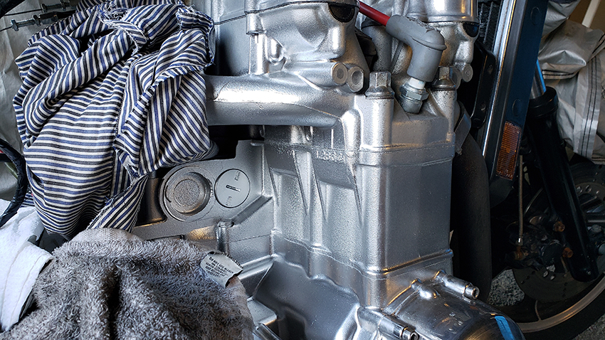

The engine is quite clean. It doesn't really need painting. Being this clean, it will be easy to prep it for a refreshing coat and touch ups. Why not! And that's what I have done. I washed a section on the right side and to already see what it will look like, painted it silver with engine case paint. And.. I like what I see. A lot! Gives me motivation to continue.

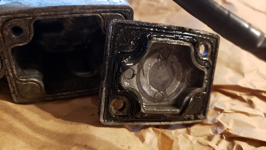

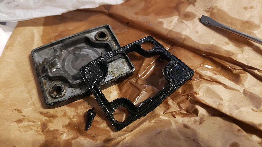

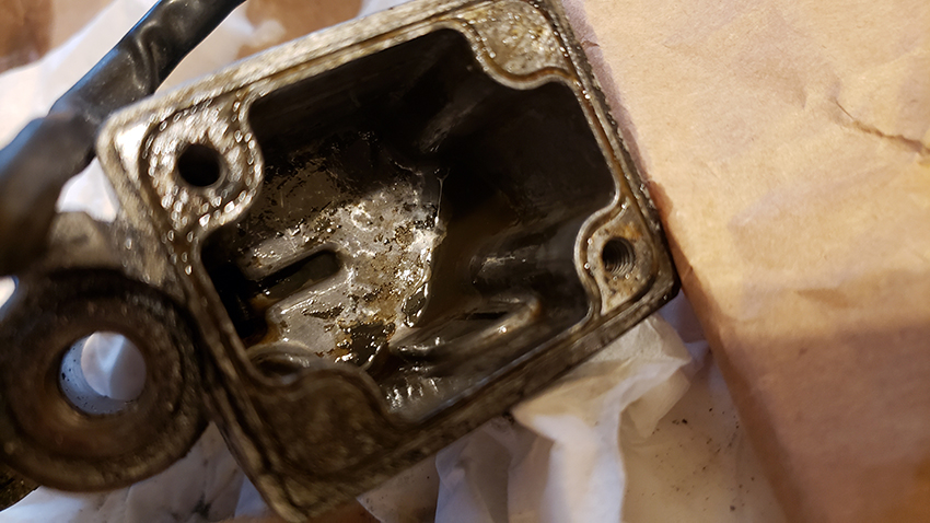

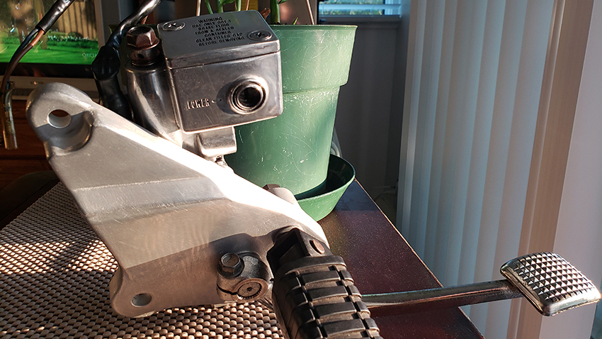

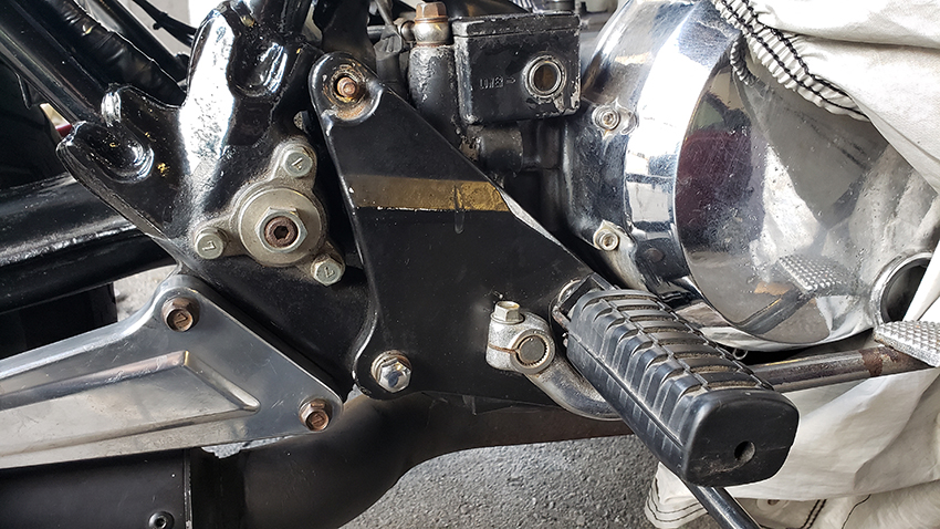

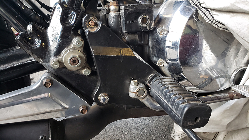

The rear brake fluid looked clean, but the whole assembly was a mess. Paint peeling off, rusty linkage, the dust boot raptured. Dirty sediments inside the master cylinder reservoir. Why? Because the installed diaphragm was not really a diaphragm! Just a very brittle what's left of it - the outer edge. That's what was left of it... and that's what was installed.

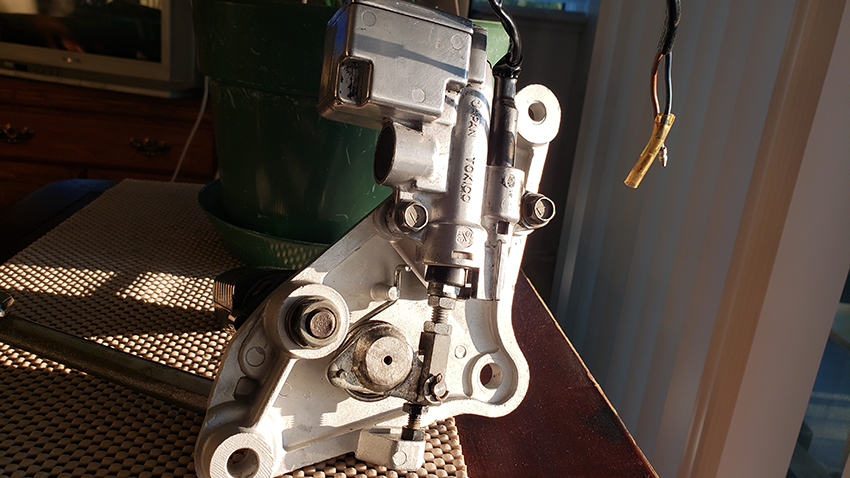

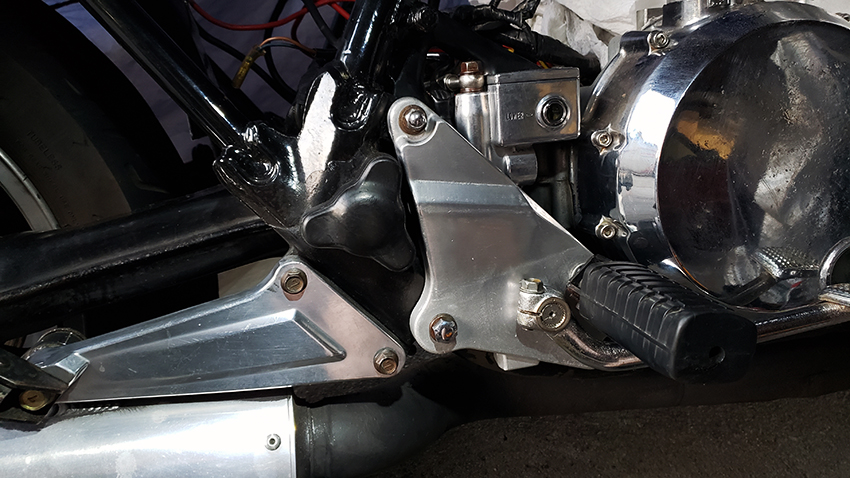

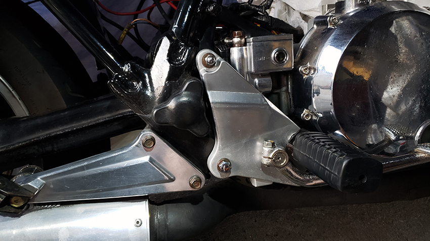

I pulled out a spare master cylinder and a media blasted spare bracket with clean linkage. I put it back together, new dust boot, diaphragm, the piston seals were in great shape and the bore smooth. Lubricated with some brake fluid and external moving parts with molybdenum grease, all fit together like a glove. After some polishing all were ready to go on the bike. It will need more polishing later, and maybe I'd paint part of the bracket black, but I am happy for now. All is rebuilt, functional, clean, and that's how it will stay.
Before and after.
Before and after.

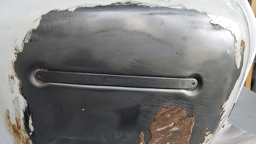

After a few times applying the aircraft paint stripper and some work with a wire brush, I saw what I was hoping to see: the bracket for mounting the Kawasaki gas tank badges is there! Very happy. It's the North American peanut shaped tank and I have a spare larger tank that I have been trying to get rid of rust. It's been a long battle and still not won. I might succeed with muriatic acid eventually. Maybe tomorrow. I am thinking about installing the bigger tank on this bike.
