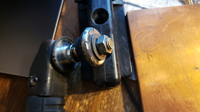

Not a very inspiring update in terms of technical data, but something that crosses my mind regarding my bike and I want to share it. Be it talking to myself.
Took a closer look at this right foot peg. The bolt there was used to secure the 6-1 exhaust, the peg bracket and the peg together. This setup does not exist in real world of stock KZ1300. But wait a minute... These two chrome collars, and the rubber, resemble something! That's right - these are turn signal collars and a damper.
My theory is - the original, or whoever the bike belonged to when it got butchered, decided to sell off all the parts for profit and have a free 'naked' KZ1300 to ride. Too bad it was done in a really crude and stupid way - wht cutting off things that have absolutely no effect on the function or look of the bike? Example - center stand brackets, battery tray mounting brackets, original exhaust brackets, etc. You can't see them, that does not serve any design as with this bike there was absolutely none, and having them off does not improve performance! Just work done without purpose other than imaginary pointless misguided compultion.
Enough about my take at the 'fabricator'. But I'd love to hear from him and ask a few questions.

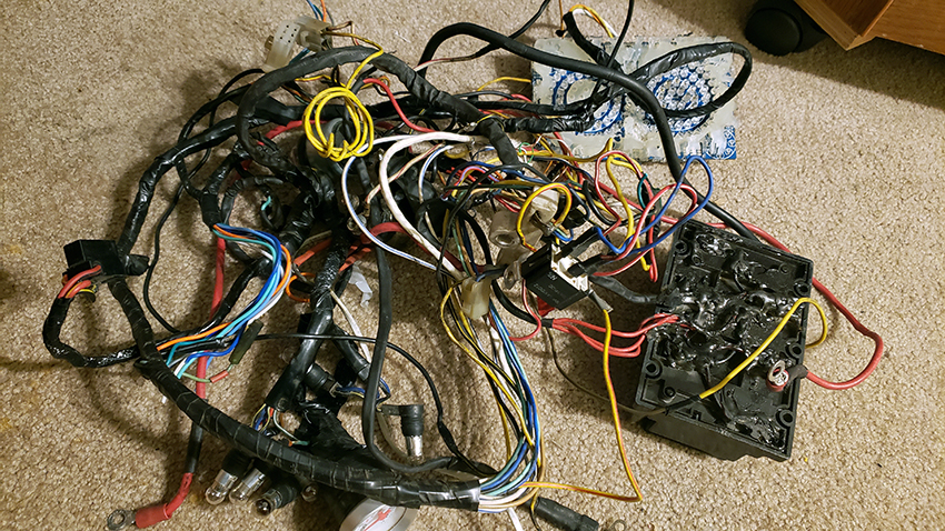

Again - most of the wire harness at home.

Well spotted on the indicator covers!

There is not much to save when it comes to the harness - all except the direct to the CDI and regulator had been cut and crimped. All connectors CUT 0FF!! What a shame. Pointless!!! Proves the guy had no long term plans for the bike. Just strip it, ride as if stolen, and discard. F_ _ _ g shame and disgrace. I am going to order a bunch of connectors and electrical stuff from a link supplied earlier - damn, forgot the address and will need to dig it out. It will not just help this build, but having 3-4 each, will be a good future investment. When I am old and stationary, or old and in need of cash to move around?
Target: connectors and different color wires.
