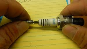

In my question I meant this versus that:
https://kz1300.com/index.php/forum/attachment/8390
With NGK spark plug boots (screwed on the cable) you remove the part attached in the top plug and use it as in the bottom. But these MSD are made and use the top set up. I was wondering if that's something commonly adopted for cars and perhaps modern bikes? "better' ? So far on motorcycles I've used the bottom plug set up only.
So... the top offers better tighter contact? Is preferable in the larger scale of things? If I leave it as is will I be ahead of old times running backwards if I decide to revert it to the bottom style.
That's what I meant scotch. Cheers!

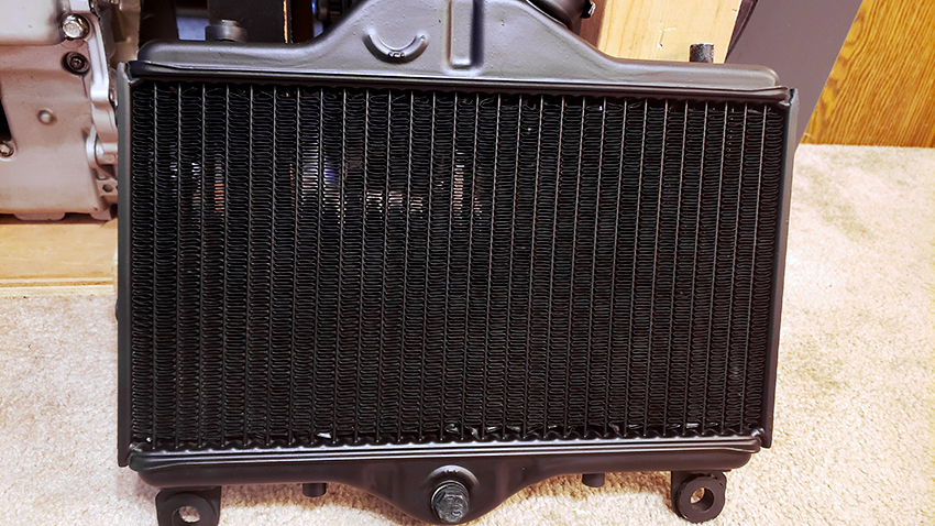

In the meantime - it's been slow. I haven't done anything last weekend. Now I'm sorting out the radiator and the fan.
The radiator was flushed and is already painted - with the fabulous PJ1 satin black paint. Same as the engine on my A4.

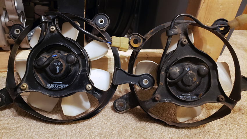

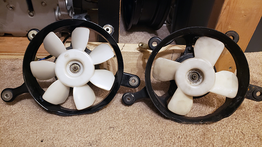

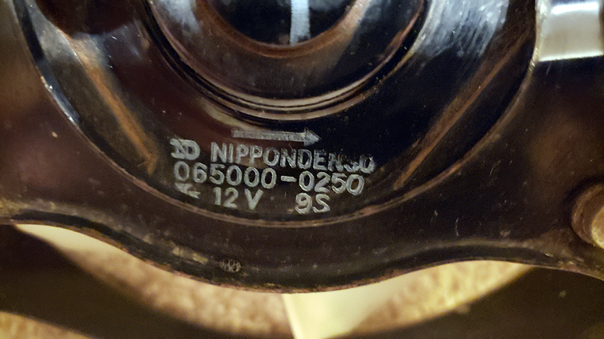

The original fan (on the right) is going to be replaced with a six blade fan I have and have been keeping to install it on the A4. But what the hell. I can always swap them in the future if I still want. The A4 is running cool, so there is no real need for it. It will be good to have two KZ1300's side by side and being able to compare how they work!
Both fans have the same mounting and same electric motors. I think there will be no problem.
