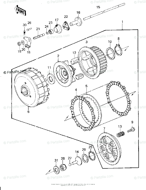

Hi Paul,
If I had to speculate, your clutch issue may be one of 3 things.
Item 16 Cam Release Inner part # 13119-1005 has 3 ball bearing pockets with cam tails. It's rotated by item 18 the clutch release lever. The cam release inner reacts against item #22 Ball Assembly, Clutch release part# 92045-1014. The ball assembly reacts against the Cam Release Outer part # 13119-1006. The cam release outer is located in the clutch release engine cover with a split roll pin.
I suspect that something happened to the roll pin and maybe the cam release outer has rotated out of position or
one of the three ball bearings fell out of the ball assembly or
The clutch release lever is worn and rotated on the shaft of the Cam Release inner.
In any event, I would focus my attention to that area first before diving in any deeper.

Thanks Kawboy,
So in the diagram, which number is the Cam Release Outer part # 13119-1006? And where is that split roll pin? Can I access any of these without having to take the main LH side clutch cover off and draining the oil? If so, then I will have a look this weekend (crazy busy at work at the mo), but if not, I will order some new oil and filter first as I will then do the oil and filter change as well as the tappet adjustment (if needed) that is required after a running in period. Bigger job altogether....

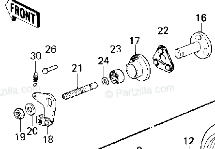

Cam Release Outer is part #17 and the roll pin appears to be at 12 O'clock. the roll pin locates the clutch release outer to the outer cover. You would have to pull that outer cover to inspect.
Siggy may be on to something. i have seen it before but it usually shows up when doing the initial adjustment, not many miles down the road. what can happen is the swage of the ferrule to the outer cable is not true round and it doesn't fit the clutch lever or at the other end in the clutch cover. Eventually (sometimes) the force of applying the clutch will pull the outer cable into place. Not common but not out of the question either. In any case, I would pull the clutch cover and have a good look at all those clutch release pieces. You don't need to lose your clutch again on the road.
