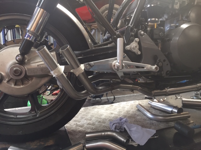

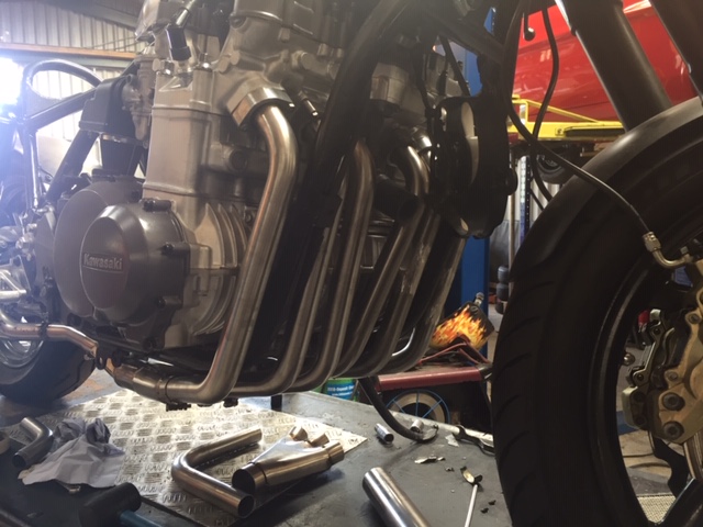

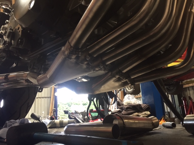

I went to see my exhaust being made, here pics of the mock-up, all hanging a little crooked at the mo. The front pipes need aligning still but he said that some of the exhaust 'holes' have been drilled deeper than normal, which is what Kawasaki used to do if they encountered imperfections in the aluminium when drilling the holes - hence the issues with none of the pipes made on his jig fitting properly on my bike.
The measurements of these mock-up pipes will be fed into the pipe bender and then it will bend all the pipes in one piece from front to collector and then from collector to the back. Rear out pipes will be much closer together and slash-cut upwards.
As you can see there are no collector 'boxes' and the collectors themselves are a much more smooth affair for air flow than the originals. He has made the diameter of the pipes just behind the collectors larger to get the volume correct, so the sound will be reduced as per the original boxes (3 into 1). The other reason why it is looking a little crooked underneath (but you won't see that with the bike on the floor) is that the collector boxes need to clear the oil filter.
Next week! Yey! Can't wait!
