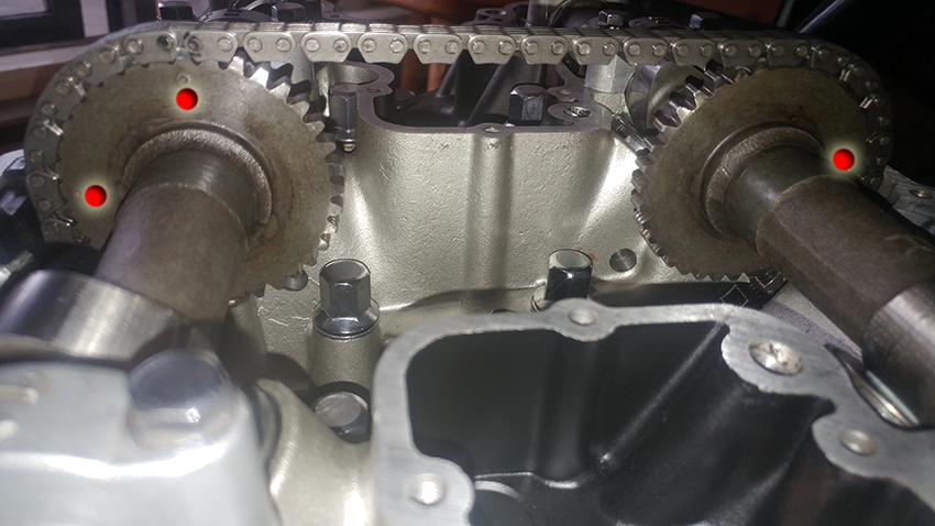

I know what I did wrong. I'm such a bozo!
Studying Kawboy's diagram for a while it struck me (it's so simple once you tweak what you did wrong - I blame the cold!)
I counted 17 links from the timing point at 9 o'clock, not from the one at 12 o'clock! :S :S :S
See if I can do a leak test tomorrow (fingers crossed!) and if all OK, try again.

Here is timing on my bike:

Just read your last message as you posted exactly when I was posting. Well, if timing was not set right that does change the perspective. To correct this would be the starting point, then a leak test to confirm all is well if you want to be meticulous.

Right, all is well. Camshafts are in and this time I counted from the right timing mark. Everything is running smoothly when I turn the engine.
One minor issue is that some of the valve clearances have changed (four exhaust 1, 2, 5 and 6 have gone smaller by 0.1 and inlet on No 1 cylinder has to be increased by 0.1)... I hope this is not because the valves have been damaged. I have ordered new shims but I guess I will have to do a leak test to be sure. But although I have a compression test set, I have no access to compressed air....
