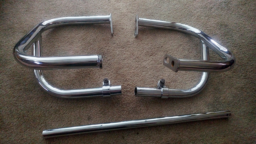

I had an AMCCO (?) two-point guard for a long time which cleared the case ends by about 1/2" - 3/4" on my '80. I've seen a 3-point mount with an additional long brace that runs back to the rear of the engine (frame). Regardless of 2 or 3 point mount, your assumption about the left hand alternator width is probably correct so spacers and extended bolts will be required as you've noted.
Depending on the gap requiring spacers - consider some 1/2" drive sockets (3/4"?). Chrome ! Shiny ! Rust resistant !

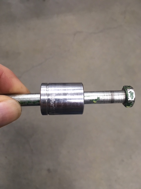

That's what I have. Can't install them unless I find a longer mounting bolt. (by an inch - inch/half)

Found a set of 3/8" drive that has a pass-through that is large enough. Naturally you'll want "Made in Japan", metric, ones !:whistle:
You may have to get "a Shop" to cut and extend those bolts
