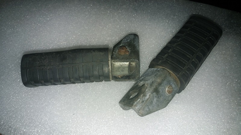

My parts list update:
I got these passenger pegs off eBay and forgot that they came with the mounting brackets! So this problem is solved
Just need to replace the cotter pins after cleaning everything.
