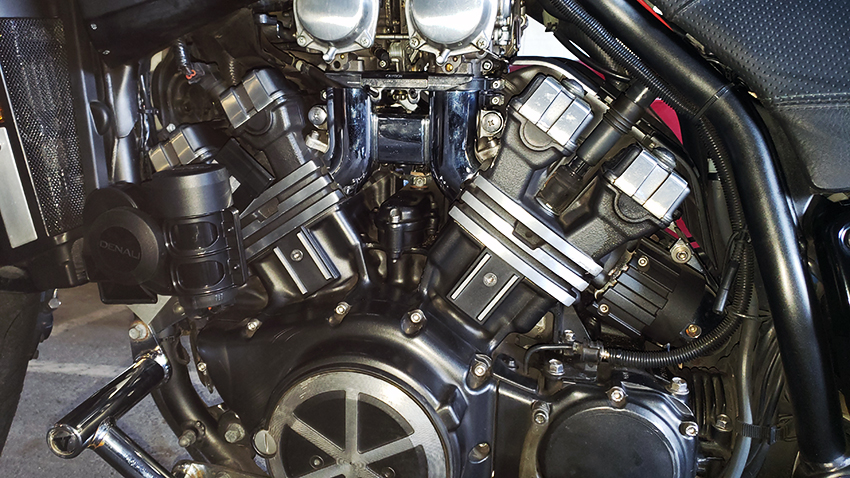

Yes Paul, the Vmax horn sounds like a mosquito! I already mounted the Denali, just need to connect. I think it's vital to have it!
I already eyed the KZ1300 for a place to mount one. Not easy! But I will get it done. I am thinking making a bracket attached to where the two threaded holes are on the frame behind the radiator. And pair it with a couple of small air scoops to direct more air into it (the radiator that is)

The Denali air horn works great! Still on a simple crude bracket, I will cut the corners later. I recommend it!
I think I am leaving the KZ as is now, as actually the current horn is quite loud. Not as much as Denali, but I think enough.

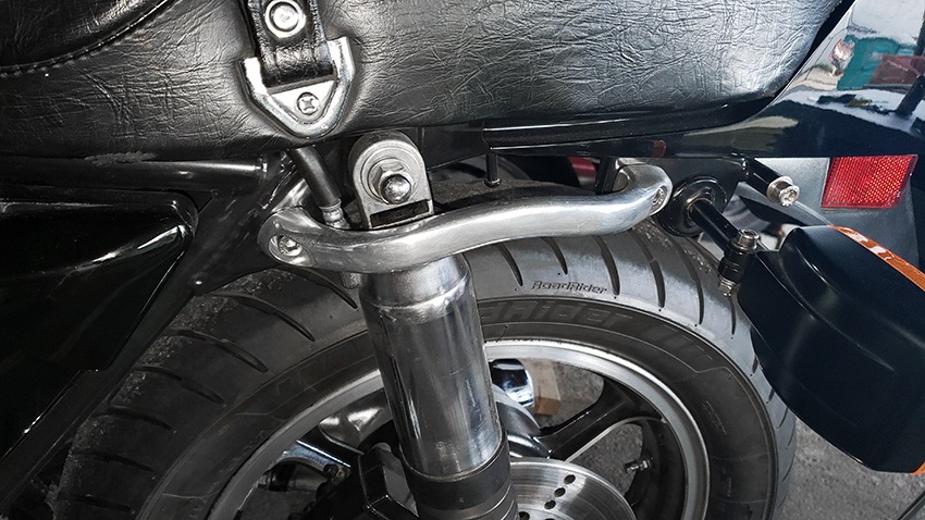

Installed the side grab handle. (thank you Paul, McBoney!) I had to remove the useless stock helmet lock, but keeping it in a drawer for originality when needed. And it was truly useless - there is no way to use it to lock a modern helmet. This handle looks cool, and is helpful.
I was going to make my own passenger grab rail, but still without a good pipe bending gadget and no welding machine, I just gave in and ordered it from the UK. From John, who was suggested a few months ago as a good fabricator who has been specializing in making them. It will be a useful addition, especially for the passenger to have something to hold on to - just in case. The seat is quite slick, and I understand the worry of sliding back. The grab rail will also look good on the bike.

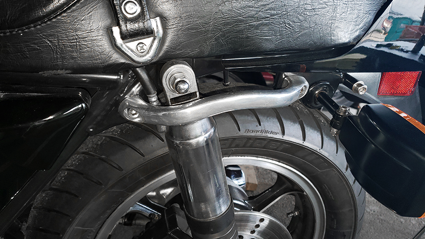

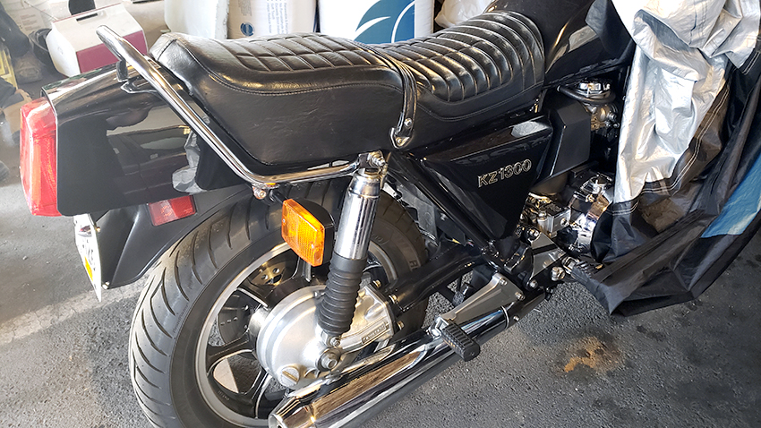

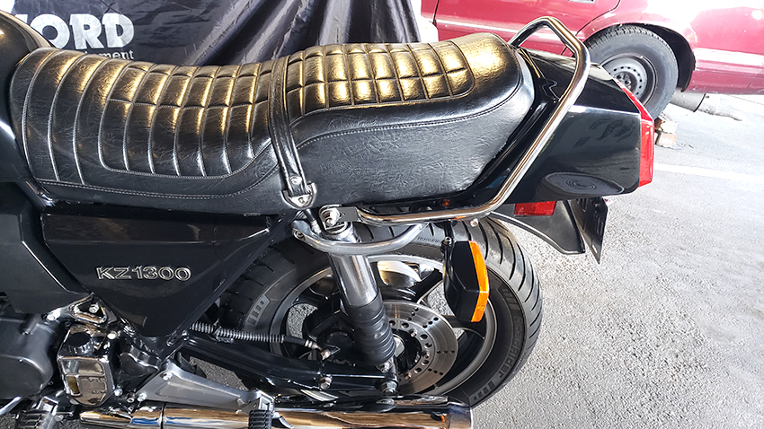

I just installed the passenger grab rail. The bike looks great! And it will be easier to strap any luggage. Also better when riding with a passenger.
I have a handle for lifting when putting the bike on center stand installed (taken off a 1979), and I had to flip it so the passenger rail could fit. Also, the original A4 helmet lock is off at the moment as it was useless - way too light to lock any modern helmet. I installed a helmet lock from another model (a 1979) on the right side. It worked well, but I had to remove it to fit the grab rail. I will be installing back the original one, fitting nest to the left rear shock, I just don't remember now if it fits with the handle.

It looks good with both lifting handle and grab rail, Stan. You’ve done such a great job in restoring that bike.
7 years 4 months agoIt looks good with both lifting handle and grab rail
It's a bit tight though with the grab rail to get a good full grip. At the same time I am not sure if the grab rail is strong enough to use it when putting the bike on center sand - which I still have problems with anyway (my bad knee and must watch my back). But yeah, it looks fancy, I like it.

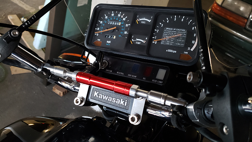

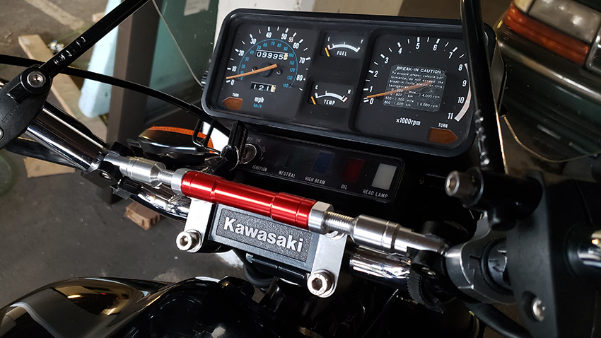

Spruced up with this handlebar crossbar. Nice red accent to my overall black theme.
And the odometer almost hits it's first 10k
I'm not putting a lot miles on the bike, but I am almost 1000 miles past the brake in distance. I think it will be somewhat fully broken in at 20k.
