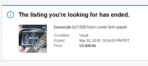

This showed up on Ebay. If anyone watched this, sorry - it's mine!
This was one of the small little details missing. I already have the bracket for it, the bike is one small step closer to be 100% stock. I will fit it but I think I will keep it off, as I don't want to have it damaged with a flying stone. Except for bike shows. It's just too nice. And I think this was a great deal as well.

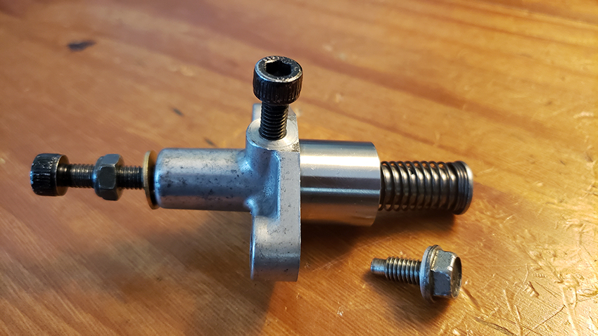

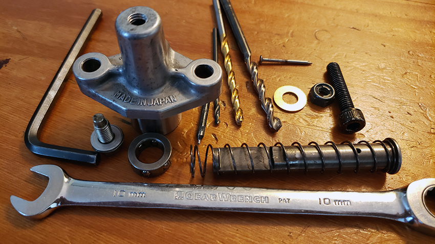

I've decided to revisit the cam chain tensioner. Right now I have a manual one installed and it's been fine. But after reading a lot of from people who are using the stock tensioner modified, I decided to do this modification as an exercise.
First, I carefully checked where the center of the back side of the housing is. Very easy, putting it on the table and giving it a spin. Like a spinning top.
Marked the center, and carefully drilled there a pinhole. Followed by larger drill bits, until the last one - 5 mm. Then cut a 6 mm thread and voila, it's ready. All freehand style
I decided to use a brass washer to protect the aluminum body of the tensioner, and also to use a self locking nut.

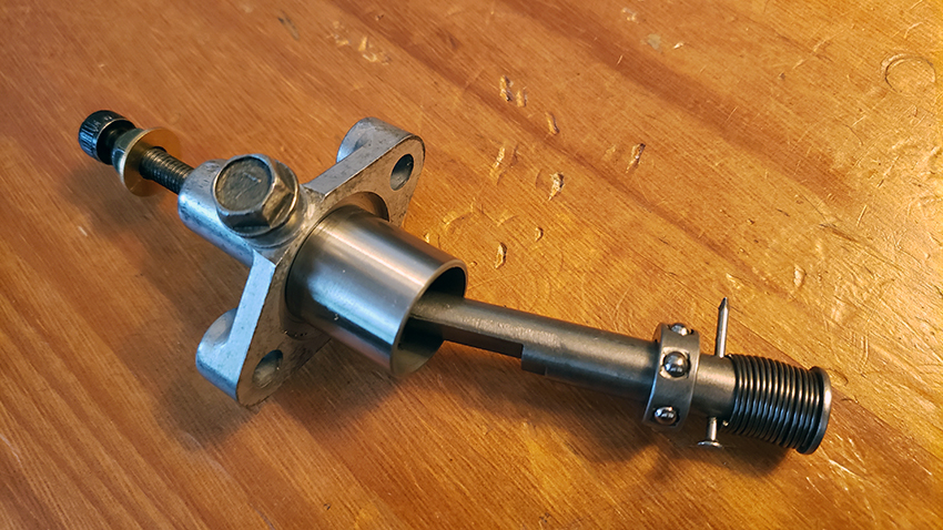

Before assembly. The pre-loaded spring is held with a nail.
The tensioner's push rod is held in place by a bolt. 0nce installed on the bike (with a thin paper gasket), I will release it and let it do it's job. Then - I will replace it with the original stopper bolt and screw the added limiter bolt in, securing it with the self-locking washer. The stopper bolt is not tight and has nothing to do with applying tension, so it will be very easy and accurate to screw in with fingers. I will back it off slightly on contact, maximum 1/4 - 1/2 turn.
So, the plan is to remove the manual tensioner and replace it with this modified Kawasaki stock. I will do it with the cam cover off, when also checking the valve clearances. I'd like to see how far it goes comparing to how I adjusted the manual one. After some more polishing that is!
Another thing to do will be to mark the different positions of the stopper bolt - all the way out, in, and the current position for reference. I will also measure it with calipers and keep track of the applied adjustment.
