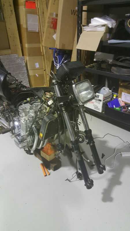

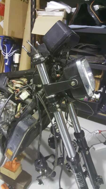

Got a bit of work done tonight.
Rebuilt forks, replaced headstem bearings, fitted aftermarket replacemtn fork ears but they are too short and the headlight points to to sky as it fouls on the bottom triple..... will have try something else.

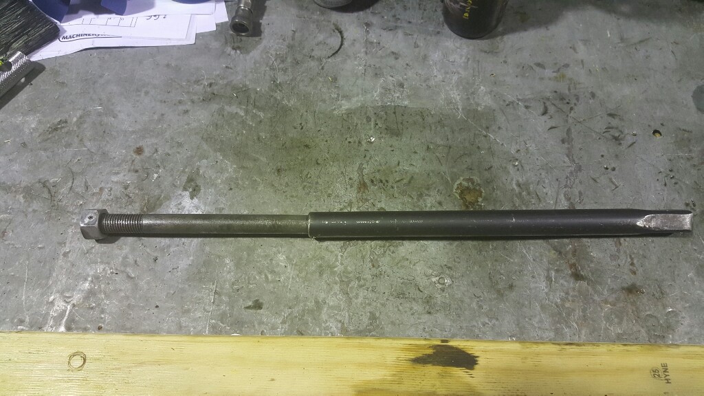

Also made my own tool for removing the damper rod as per another thread on this site. Worked a treat.
