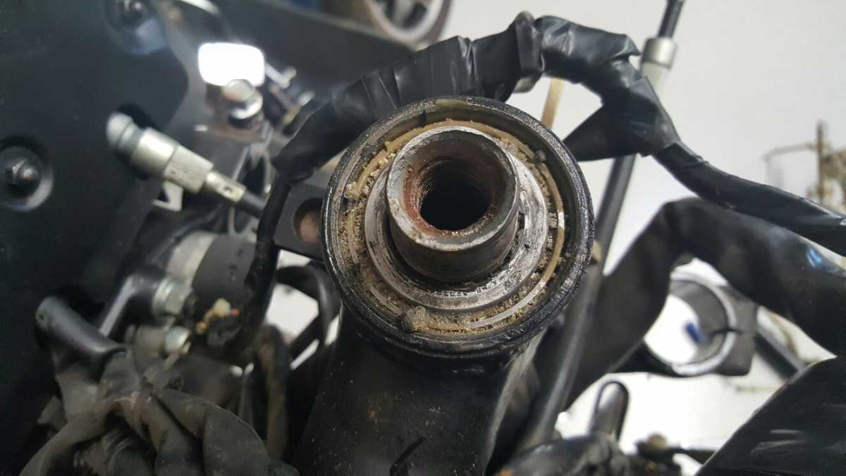

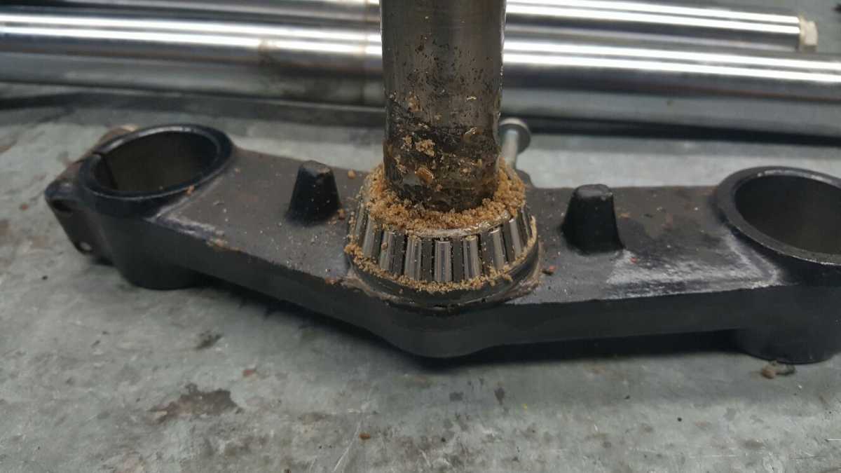

Some pics.
The delightful mess that was the headstem bearings. Had to grind the inner race off that bottom bearing.
Gotta grab some fork oil so i cn rebuild them legs and put the front back on, plus get a valve cover gasket.

Oh yeah. Had to grind off some tabs on the steering lock. They had welded extensions on them, i assume to restrict movement so it didn't foul on the LaParisienne fairings.
