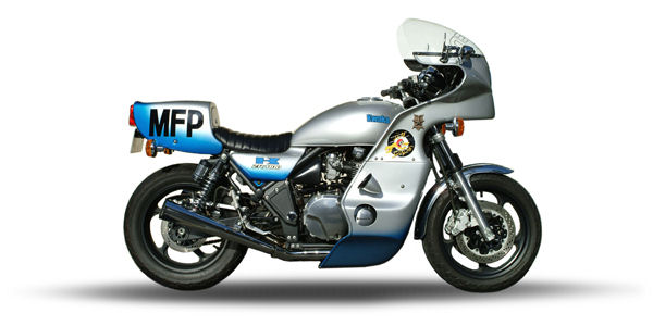

Good job getting some fire in those cylinders again!
That fairing is actually a pretty nice piece of kit, any info on who made it? I would keep each and every bit of the that fairing and it brackets if it was a special order for the 1300.

Just looked at the pic with the fairing on and instantly wanted on my bike , Jim Goose and the other Mad Max Zd's made them totally iconic...I want it..but you're in Oz, where it should be

The fairing is a La Parisienne. It is definitely made to suit the Z1300. I'll be hanging onto the fairing/mounts/etc, wont be putting them back on though, I like em naked!
