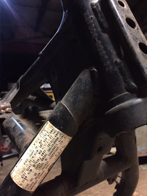

I'm wanting to powder coat my bike frame, but the guy says the VIN sticker that has the frame number and the date of manufacture on it will be lost due to the high temperatures in the oven.
Any ideas on how to save this/get a replacement? I did make a picture for future reference should I need it to register the bike...

A good vinyl graphics shop can reproduce that for you. Make sure you take measurements (length x width) and make sure you can read everything on your pic. They will literally type out a new one and print it off. Discuss all of this with the shop you choose before starting the powder coat project. Shouldn't cost much more than $10.

You could carefully pull off the original using a very small amount of alcohol or lacquer thinner - or from the guys over there at KZ Rider
