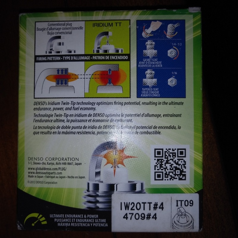

Thought I would fire up a new topic on Spark Plug options so that it's easy to search for.
Building on DARO's topic for ignition upgrades, one of the things Daro looked in to was whether or not the iridium center electrode plugs similar to NGK BPR6EIX had any effect on the spark generation and it did. Daro attributed it to the smaller electrode and having less electrode area to have ionize the in the gap between the center and ground electrode.
I had seen somewhere in the past double iridium electrodes and started investigating. What I came up with after exhausting every avenue was a plug from Denso which has an iridium center electrode and a platinum ground electrode both are .4 mm in diameter. Plug number is an IW20TT They are a 5K ohm resistor plug ( I measured it) Looks really interesting and at $10 a plug not too bad.
When I finally get around to finishing up the beast, these will be going in.
Pictures are worth a thousand words

Just thought that this info from Agmonmarine testing these IW20 TT Denso plugs should be included in this topic.
"Quote posted from Agmonmarine 21 June 2020 The never ending projected has ended...for now.
"well..I have reached Shangri-La with my 1300, finally the engine is working as it should, starts good, idles on all six and accelerate with no hesitations and pulls strong all the way to 8000 RPM like a rocket ship.
Over the years I felt the engine never run good as it should, many times I thought I solved the issues with new ignition system, cleaning the carbs thousand times but there always something not 100% and it drove me crazy!!!
And then I read Kawboy topic about spark plugs, so I went ahead and got 6 of these Denso spark plugs replace the NGK Iridium plugs and BOOM! its a rocket ship, just like that.
It seems that the Denso were the missing link to reach Shangri-La total bliss.
Thank you Kawboy
I have put just over 300 miles with the new spark plugs and its still a rocket ship and feel that this is it:) the project is done and I can move to my next project my 1985 Moto Guzzi Lemas 1000 for little update.
WOOHOO!!! See you on the road Adios"
