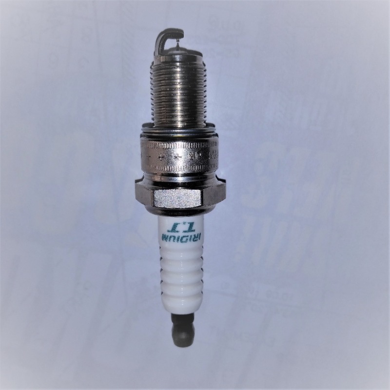

Thought I would fire up a new topic on Spark Plug options so that it's easy to search for.
Building on DARO's topic for ignition upgrades, one of the things Daro looked in to was whether or not the iridium center electrode plugs similar to NGK BPR6EIX had any effect on the spark generation and it did. Daro attributed it to the smaller electrode and having less electrode area to have ionize the in the gap between the center and ground electrode.
I had seen somewhere in the past double iridium electrodes and started investigating. What I came up with after exhausting every avenue was a plug from Denso which has an iridium center electrode and a platinum ground electrode both are .4 mm in diameter. Plug number is an IW20TT They are a 5K ohm resistor plug ( I measured it) Looks really interesting and at $10 a plug not too bad.
When I finally get around to finishing up the beast, these will be going in.
Pictures are worth a thousand words
