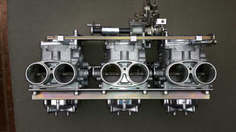

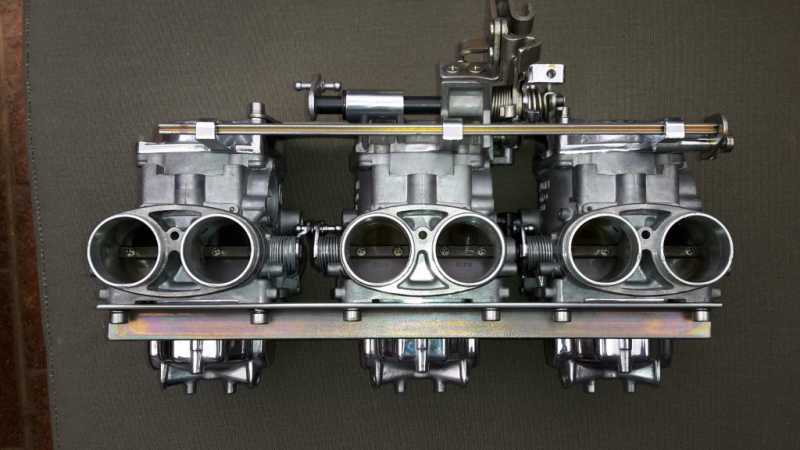

I had a set of carbs go like that on me. WD40 and elbow grease got me through it.... Picture below mostly assembled after the 'elbow greasing session'. Tuned and balanced them on the bike ...and touch wood, all going well 3000 miles later. Good luck!
Last edit: 11 years 2 months ago by Craig. Reason: Add picture
- Posts: 973
Re: 1979 Carb Rebuild (Pt 1)
That looks like a PROPER restoration job, Craig. I take my hat off to you. Did you have the brackets, springs etc yellow passivated? the finish looks as new. I wonder if fine bead blasting is a good idea for the carb bodies? i believe it closes up the pores of the metal, therefore reducing the chance of surface degradation. I love it when parts LOOK beautifully finished!
