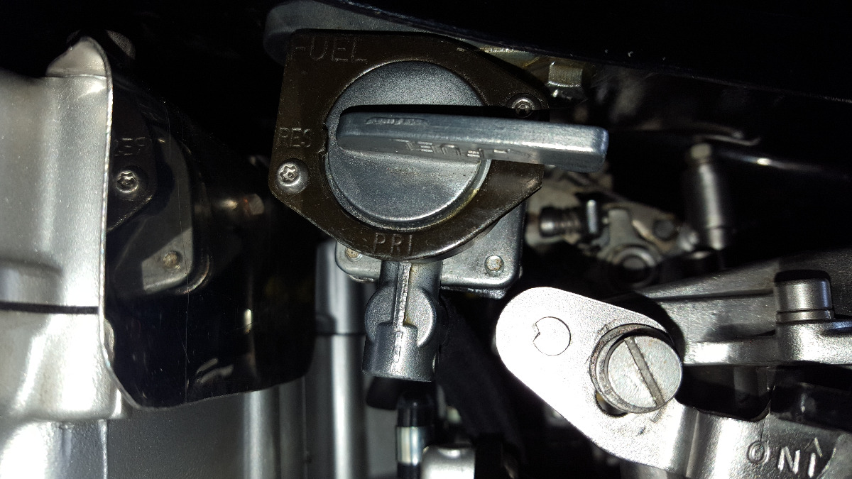

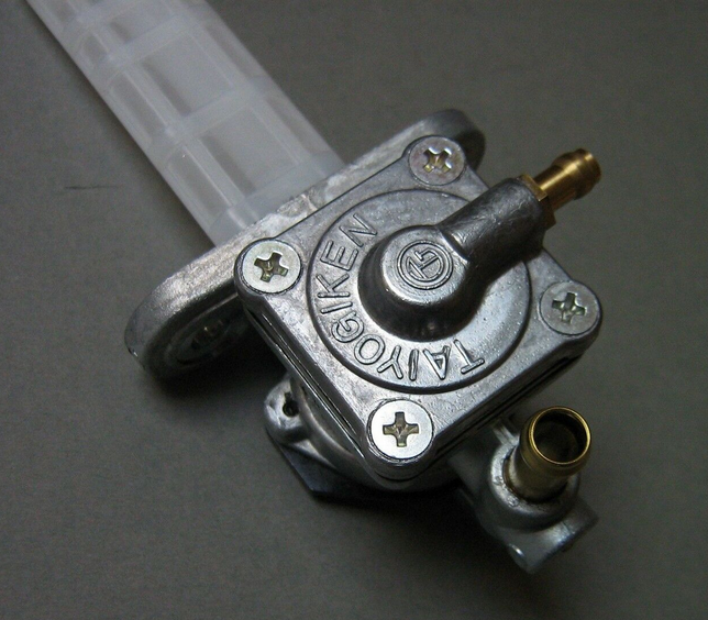

Re: GPZ900R Vacuum Fuel Tap...............Questions.
Here you go !
GPZ900R Petrol Tap.
Has the same hole Centre to Centre as the Z/KZ1300.
You can remove the rear vacuum plate and re-fit with the vacuum pipe in a different direction.
One of the photos is the same tap fitted to my current Z1300.

Thanks for posting Peter. Can you measure and post that centre-to-centre distance of the tank bolt holes - I have a feeling the ZN hole spacing is different but can't remember.
Thanks for replies.
Bucko,
The hole centres are approx 44 - 45mm.
Hope that helps ?
