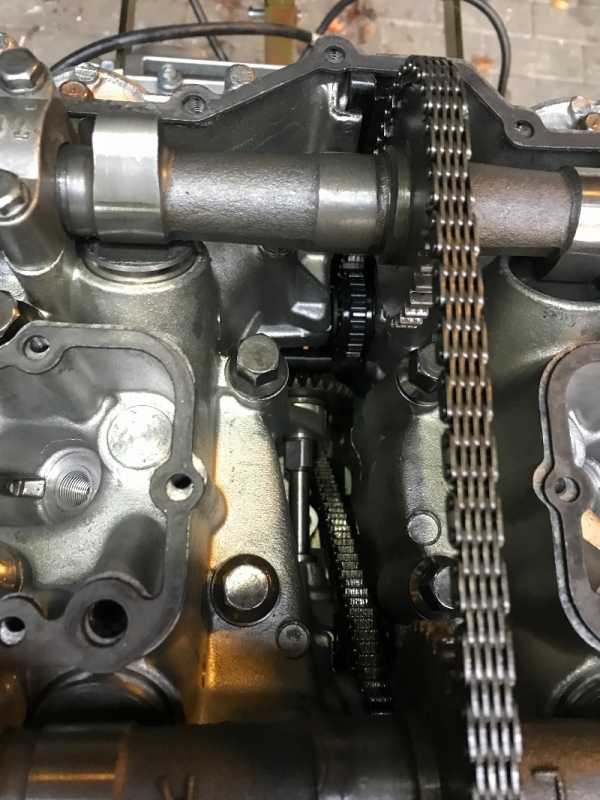

Cylinder head back from machine shop. Looking fantastic
New guides, valve exhaust. Valves seated, replaced oil gasket, valve adjusted ++
When I compare Liska gear with oem gear, I realize that the oem gear is in excellent condition. I will install the Liska gear anyway.

6 years 8 months agoJorgeno wrote: When I compare Liska gear with oem gear, I realize that the oem gear is in excellent condition. I will install the Liska gear anyway.
Thanks for posting this. The last time I had the valve cover off my low mileage ZN, I carefully inspected the idler gear as it looked worn - didn't realize it probably looked the same way new (or reasonably similar) - which your photo nicely highlights.

The odometer shows 40.000KM and the oem idler gear is good
Cylinder head back on. Beginning to look like a great engine again
First I put the cam chain one (half) tooth wrong, and turned the engine around 4-5 times. For a moment I thought that now everything was wrong. Valves was bent or broken? ..
I didn’t feel any resistance so I think it’s alright. The cam chain is now correct

Have to agree: You're OEM gear is in excellent condition. I really like the engine stand.. Nicely done !
