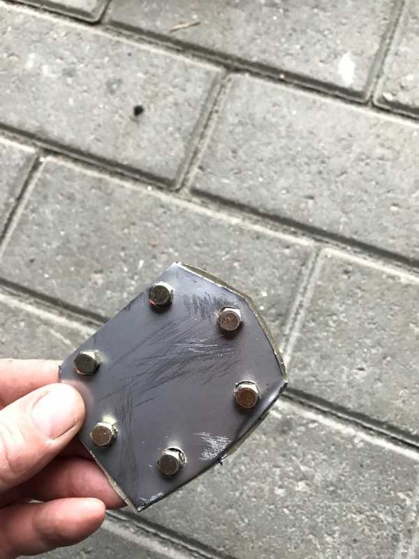

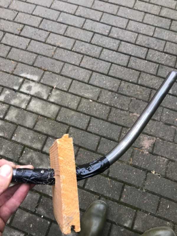

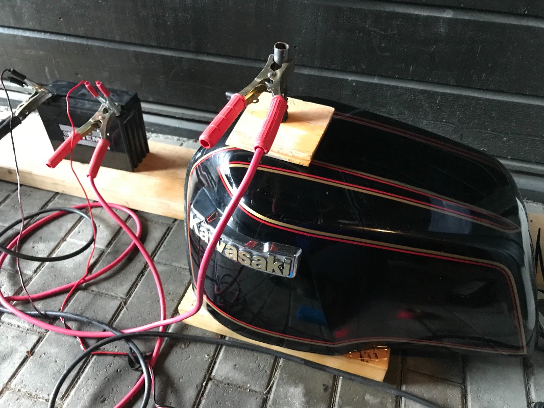

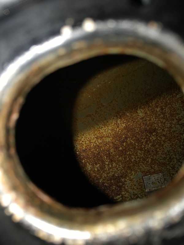

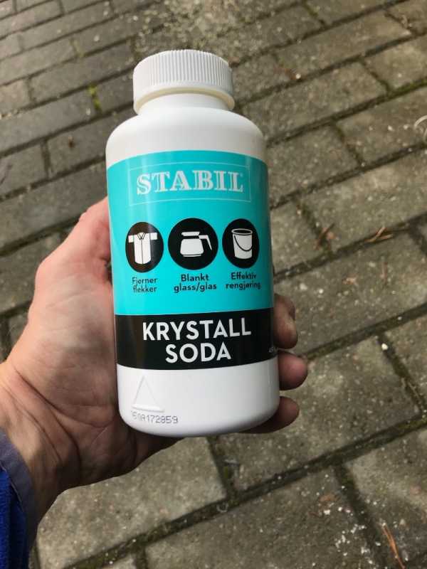

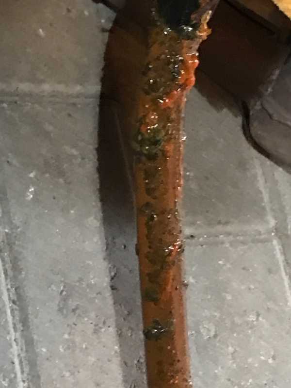

Have started a slow rebuild of my 85-model. Today I started to clean the gas tank. I have read that electrolysis can give good results. It’s cheap and effective. I have never tried it before but I wanted to give it a try.
This is how it looks after 6 hours.

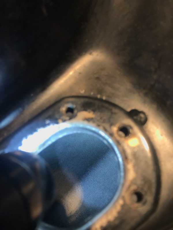

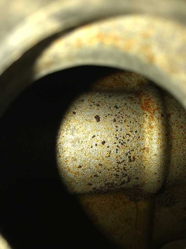

The electrolysis test went great. The process require little effort and the result is fantastic. Now the tank is clean on the inside and on the outside

Looks great. Nice and clean. Will you be sealing it now with POR 15 or another product? I ask because the metal in the tank looks very pebbled and would probably benefit with some kind of sealant.
