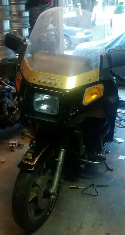

I didn't think of grabbing any pictures until I already had it in the garage and its a bit crowded in there but eventually I'll certainly post some. First thing to be taken care of was the tank so i cleaned it and it seems essentially rust free from what i can tell. Got her running yesterday with a E2000 airtex fuel pump and T16L Autocraft AGM battery from advance. First start took a minute and I didn't notice the throttle was stuck completely open so it was a loud start followed by immediate shut down. After that was figured out it ran although smokey and not a fan of idling. I'll try to spend some more time on it today so I can refigure the fuel routing and make a bracket for the filter.

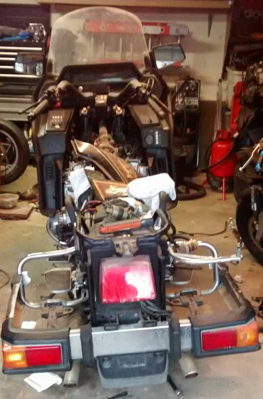

From a few days ago the garage is a big mess at the moment. I got it complete and still have everything just easily to mess with fuel routing and the battery like this. This bike certainly needs to go on a diet I don't really think I could ride it like this. Currently thinking of doing like many others before me and stripping it down. Nothing crazy just remove some of the mass and see how I like it. You may see all the luggage and fairing bits up for sale one day.
