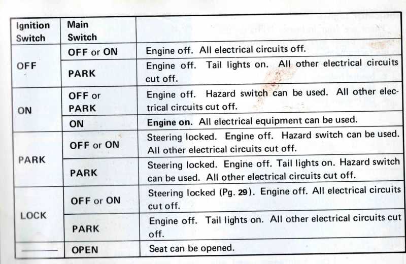

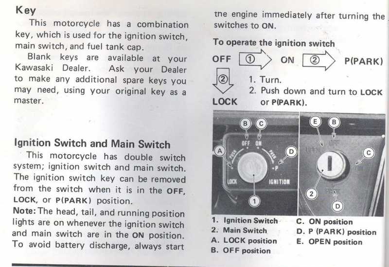

what is the key hole for in the left side panel??or what does it do ? :huh:
zed 13 1979 A1 model

It's a main switch and seat opener, it's in the kz1300 owner.pdf download file on the site, here is a photo of the page, cheers

many thanks it might start now lol :P
