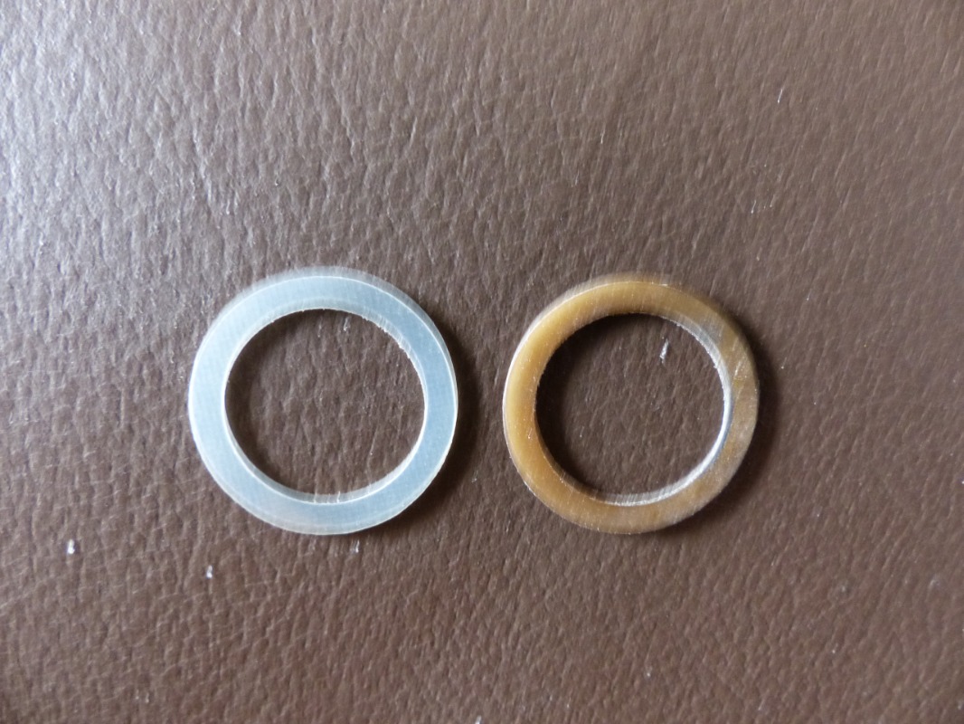

After several frustrating rounds of chasing a fueling issue, I did a full carb rebuild (literally everything, including diaphragms, cut off valves, etc. Pretty much everything I could think of updating) and in the process, I apparently misplaced the small plastic (Duracon) washers that go on the slides (see attached pics, including one I took from one of Scotch's posts reminding us to not forget them

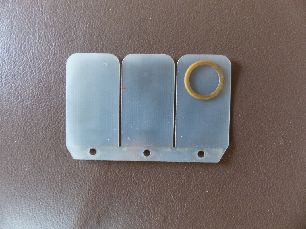

I made a couple of sets from a reed valve from a 2 stroke intake. Worked like a charm. The reed valve material is compatable with the fuel and also, the thickness was within .001" of the original material.
I remember drilling a smaller hole like 2mm in the reed and opening it up carefully with a tapered burr and then grinding the od to size with a fine stone grinder. Finicky job but in a pinch, it worked.

Thanks Kawboy! That's a really good idea! I was worried about making some out of sheets of another kind of plastic since it's in contact with fuel, but those reeds would work great!

".....worried about making some out of sheets of another kind of plastic since it's in contact with fuel,...."
They do not come in contact with fuel ! The concern is; using a material that won't warp. kawboys idea is good. That material is stable and the ,001" difference is of no consequence.
