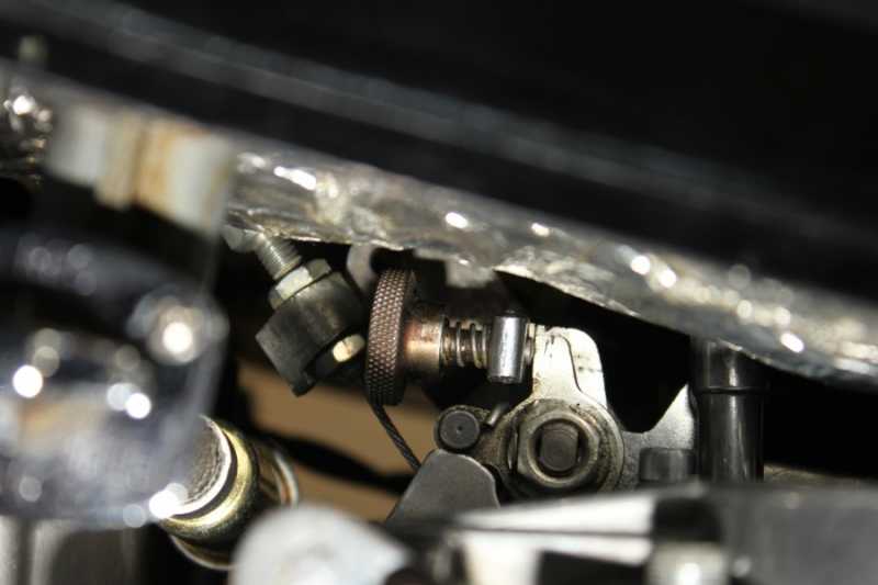

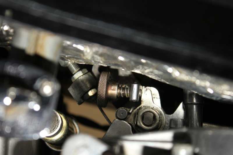

For myself it all FINALLY came down to the Fast idle adjustment. It was flooding during start-up because the choke plungers were lifting too soon relative to the high-idle cam "cracking" the throttle plates. Add to this random equation, air temp., Humidity, bike temp., battery condition, and the myriad of other quirks that require refinement and you can appreciate this took a number of gradual adjustments and some "1300 patience". I agree with "Strate6". I tune mine however by EGT/ header temp. using an infrared temp. gun. What made this final adjustment far easier was the addition of a small "thumb-wheel" on the fast-idle adjustment screw-head. Trying to adjust this mechanism with the stock screw was nothing short of obnoxious. I started with the recommended .54/.55mm gap but saw this change slightly to get the starting characteristics acceptable. This has payed-off huge but none-the-less requires everything else must be in correct working order and adjustment.
Last edit: 12 years 6 months ago by scotch. Reason: incorrect picture
