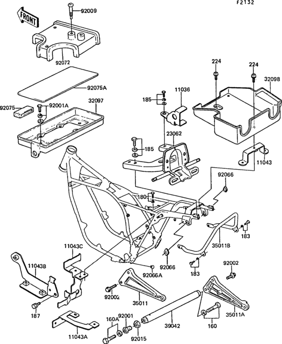

Hi can anyone send me a picture of how the battery band is mounted please mine is missing i should have got one when i brought my fork ears thanks Graham

Hi Graham
I might be wrong, but the battery is fixed with a rubber part (92072) that's is fixed with a screw (92009)- see attached:

Hi Graham,
The band is held in place with the long bolt as shown, the bolt has no threads in the last 8 mm.
