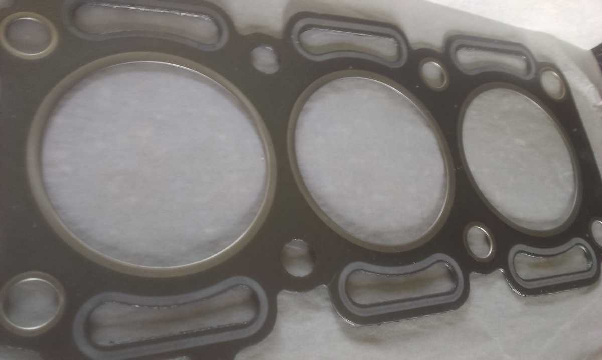

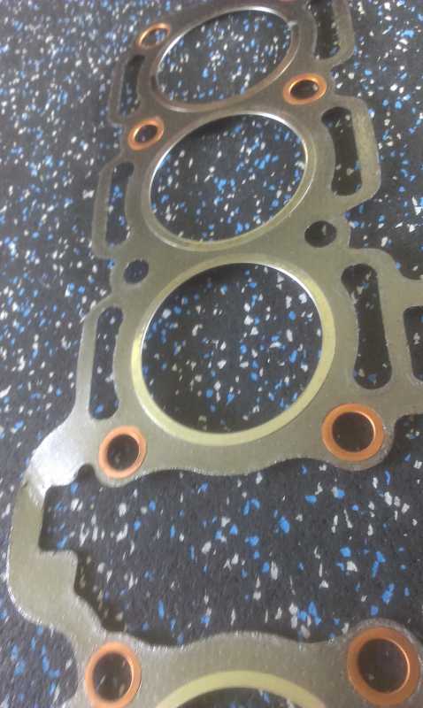

Seems there are conflicting views on the whole subject. I'm about to do mine, I've got a genuine head gasket to use and an aftermarket which is in the full set I got for the rest of the job.Does anyone know when Kawasaki stopped making head gaskets and is age a known issue, ie if a gasket lasts 30+ yrs in the engine would it degrade on a shelf in a bag? I bought a tube of threebond which I'm now unsure whether to use.
Pete , I am guessing you have fitted a number of genuine gaskets over the years and not used any sealant and never had a failure?
PS just taken both head gaskets out of the bag. The genuine looks like it could have been made yesterday..so thats good. The aftermarket as said has no silicone round the coolant holes and just looks like a poor quality item, so all I suppose is on condition, mine definately looks good to go straight on
