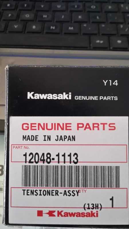

I Have a Kawasaki Cam Chain Tensioner part no 12048-1113 parts advise it fits a ZG1000 concours 86-2006 has anyone used one of these before, This is an automatic tensioner so if could be used I imagine 10mm of spring will be required to be removed, to prevent wear and tear on the cam chain tensioner sprocket

Not sure on the part number as never used it for reference before but as long at its the same number as the ZZR1100 or GPZ900R it will be ok.
They have the same 2 hole pitches as the Z1300.
If you post a photo of it I can tell you immediately if its the correct one.
Pete

Yes, I have used one of these and no problems at all in 16000km so far. As you stated though, you must cut 10 - 12mm off the spring to reduce the tension slightly.

Cheers Pete and Craig thought I could but good to hear from someone that has tested. Will chop 10mm of spring when fitting and hopefully tensioner wheel won't wear out, rapidly as has been the case with others.
