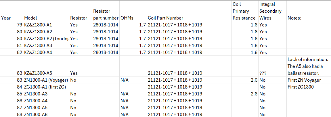

Going by the part #s, 1982 KZ1300 A4 was the last year that used the ballast resistors in conjunction with coil part # 21121-1017 / 1018 / 1019
In 1983 we see no ballast resistor listed and the part# for the coils changed to 21121-1112 for all 3 coils and this new coil now has secondary ignition wires as a separate part.
I don't see a listing for a 1983 Kawasaki KZ1300-A5 . 1983 appears to be the first year of the ZN1300 - A1 Voyager.

The old FAQ devotes pages and pages to coils. I've researched the statements and assertions that are made about the topic and cooked 'em down to this:
If your bike is a Z or KZ A1 thru A5 it uses a ballast resistor in series with the coils, which are marked "ZC005-TR12V". If you are planning to replace your coils, whatever configuration you are planing to use, the total resistance should remain the same, or nearly so. For any of these bikes (A1 thru A5) replacing the original coils with modern 3 OHM coils will allow you to delete the ballast resistor entirely.
I'll give one first hand example: My '81 KZ1300-A3 had a 1.7 OHM ballast resistor in series with a 1.6 OHM "ZC005-TR12V" coil for a total resistance of 3.3 OHMs. I replaced the coils with 3 OHM Dyna brand coils and eliminated the ballast resistor. That was fifteen years ago.
Starting with model year '83 the ZNs and possibly the ZGs substituted a different ignition coil without changing the part number. This new coil is labled "ZC006-TR12V" and measures 2.6 OHMs primary resistance. No ZNs and I speculate that none of the ZGs use a ballast resistor. (Need some help. Any ZG owners in the room?)
I cannot say I'm solid on this information. If you've first hand information, that's contrary to any of this I'd like to hear it.
Here's a spread sheet I've complied:
Comments?
Comments?
