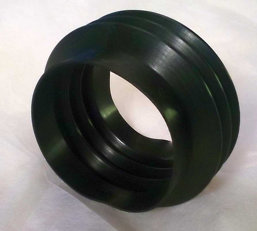

Hi,
I supply the swing arm boot, it is listed on eBay.
Looks like this, made from NBR rubber with molding process, not glued together from discs. Very flexible, I installed it on my -82 without removing the swing arm. I just opened the fixing bolts at the engine end, pushed the flange back and wiggled the new boot in place.
Hope this helps, Lauri
