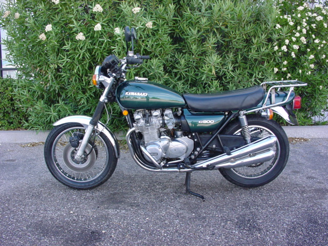

Hi Tad,
I don't believe they fail at any unusual rate. As RickG says, gaiters are the way to go. I actually prefer the look, makes the forks look more substantial.
I've got 'em on my 13 and my 900.
