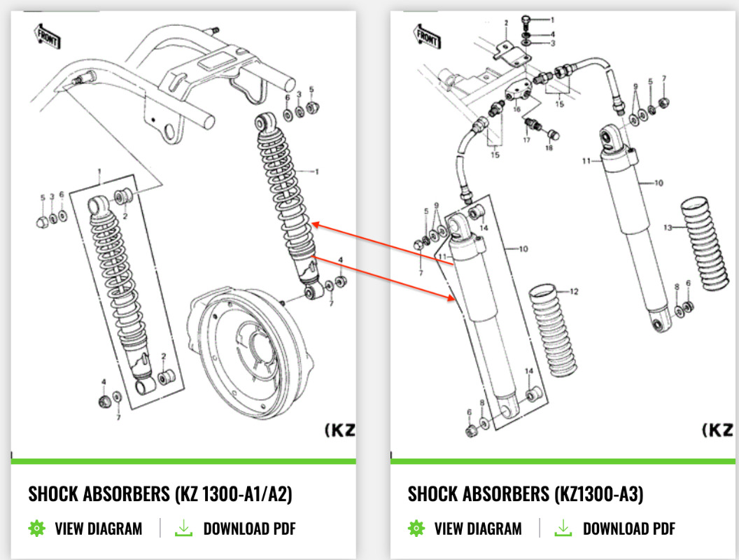

Got around to test fitting the YSS shocks on the 1981 KZ1300 as the two shocks are entirely different.
The 79 and 80 shock is a plain Jane emulsion shock. The 81 and 82 have air assist, and were made by KYB, model 1118.

From Kawasaki’s “Owners" section…

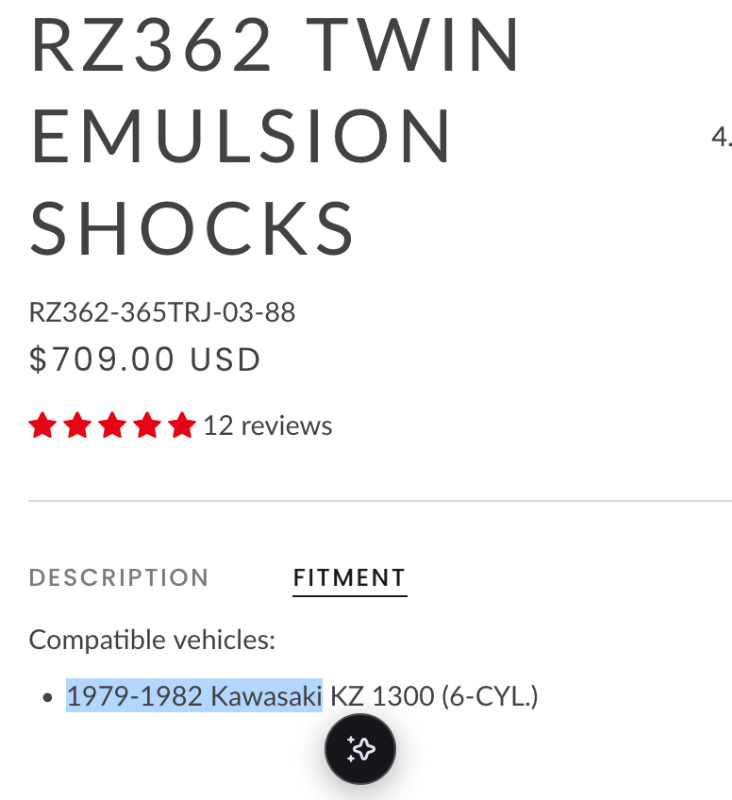

This is not true.
From the YSS website , 1979 thru 1982 shocks are compatible.

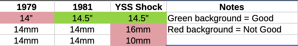

Here are actual dimensions….

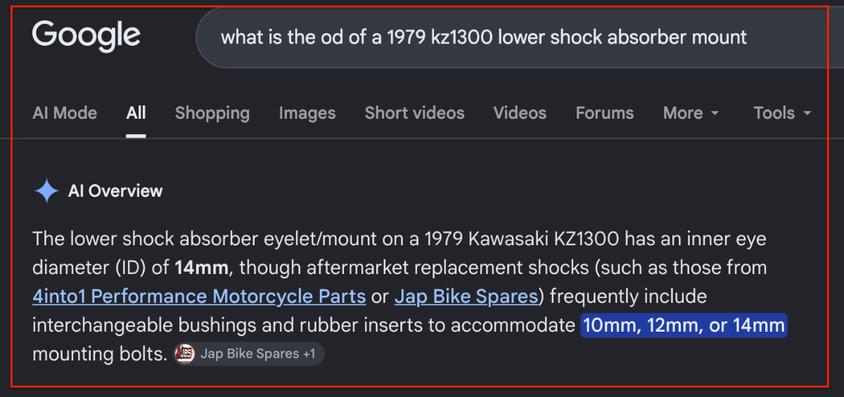

Back to my friend AI, it looks like some manufacturers offer various bushing sizes..
I wonder if YSS could provide the correct bushing size

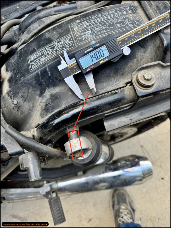

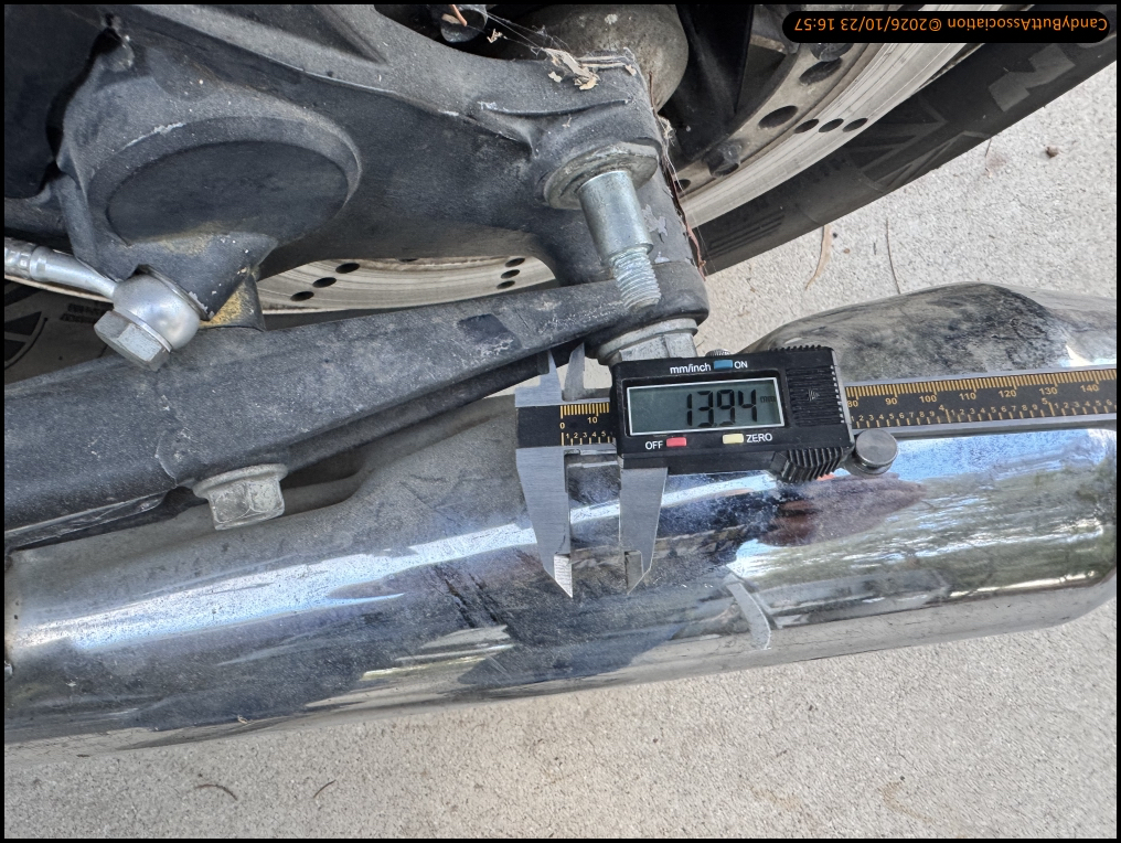

The upper mount OD is 14mm.
The shock upper mount ID is 16mm.
The upper mount on the bike is 14mm.
2mm too large.
Lower mount is 14mm.

This is not true.
2mm too large.
