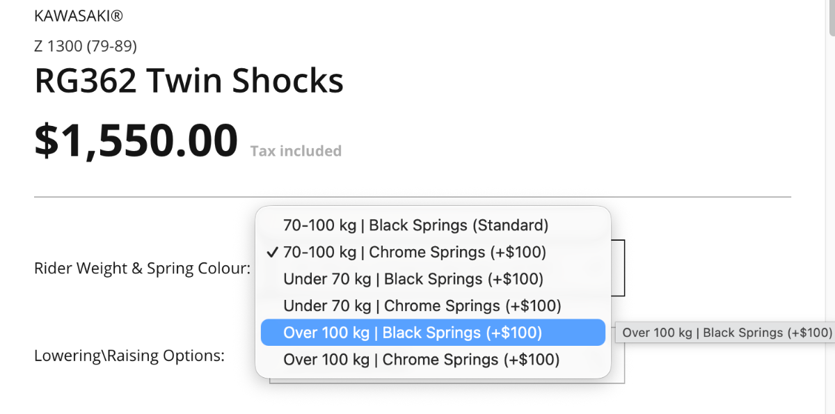

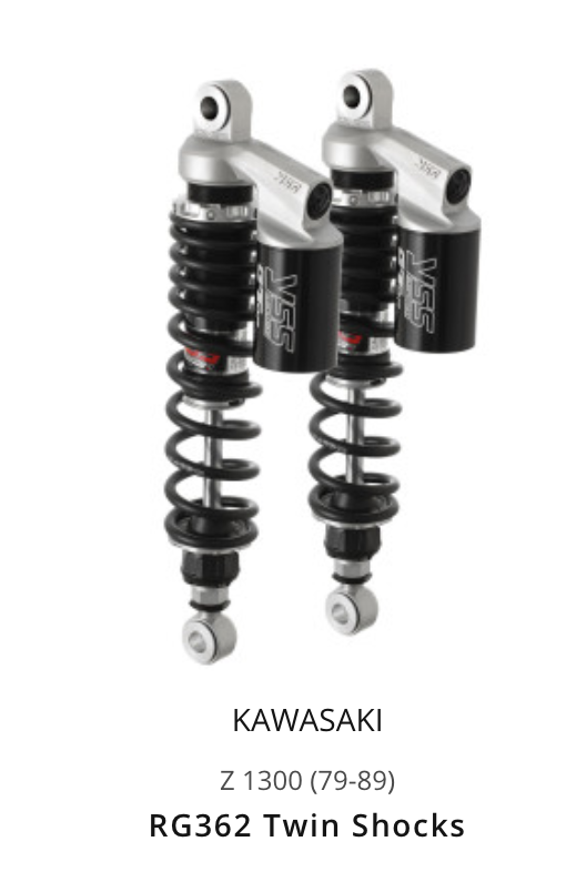

Ordered these from YSS.
They should arrive in about 5 weeks.
Fully adjustable - Threaded spring preload, fine-tune rebound clicks, and multi-position compression damping.
They even have different spring rates available.
This price is in Australian dollars. USD from Traxxion Dynamics was $900.

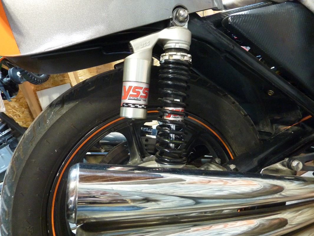

That's a lot of money to pay for rear shocks. But there again, I've had mine for about 10 years. Bought from a company in New York. They were about $1200 Cdn. back then. He also supplied a pair of "Fork Emulators " as they called them. A small adjustable disc that were dropped down inside each fork tube to give better fork oil control / dampening . It sat on top of the dampening rod, then new shorter fork springs , a pvc spacer , then the top bolt. Essentially converting the forks to cartridge type. For every day riding , couldn't feel much difference , but looks cool .
