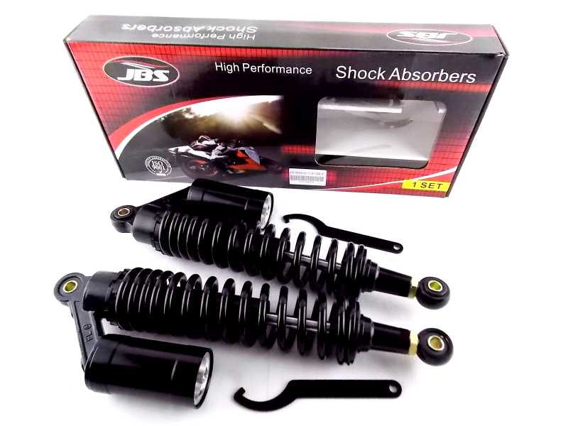

My 2 cents:From day one, the OEM rear shocks were inadequate for two-up and gear. I replaced them with a pair of S.& W. air shocks. With a “passenger” and no air PSI the S. & W.’s were too hard. I haven’t had a “passenger” for years so went to these:
I found these to be too hard! I took them apart. The nitrogen cannister has a bladder that separates the gas from the oil but the gas volume is so little; I found it useless for its purpose. I removed the bladder and most of the oil. They are installed with a cross-over and gauge. With a small bit of spring pre-load and 20 PSI the ride is compliant and comfortable!

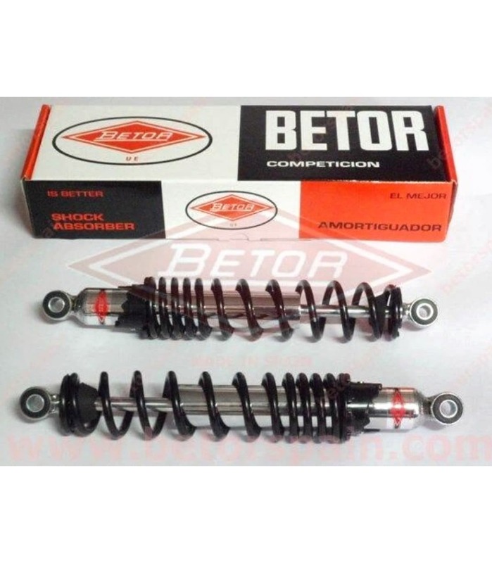

Once I solve the engine part, if I ever do, I will have to adjust the shock absorbers, Christine behaves like a merry-go-round horse.
I was planning to buy this pair of Betor shock absorbers, the store where they are sold is just 8 km away. from my house.
BETOR SHOCKS
