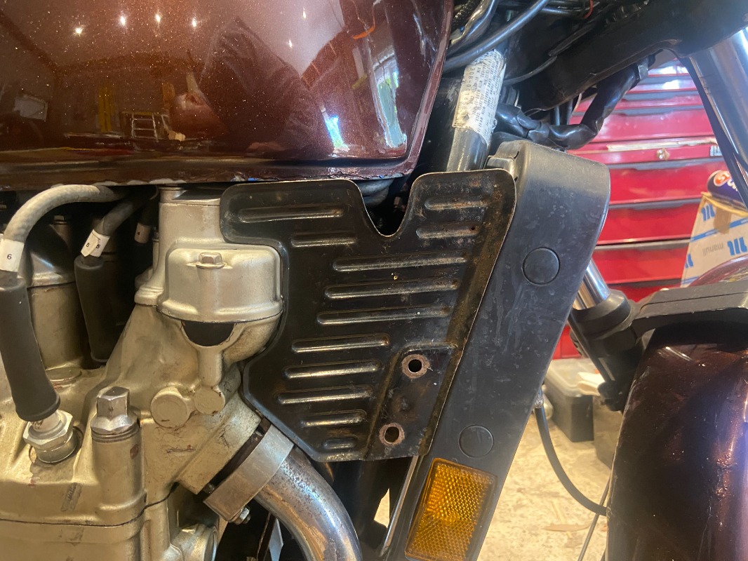

What are these two holes for?
  • Ted
  • Ted's Avatar Topic Author
  • Posts: 110
  • Thanks: 27
2 years 4 months ago - 2 years 4 months ago
#32696
on the frame between the rad and the engine.  They are threaded and I looked at pictures of models when new but have not seen anything there.
Last edit: 2 years 4 months ago by Ted.

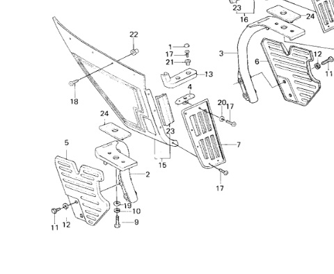

The B2-Touring mounts for the upper fairing go there. There's another pair of threaded holes on the front of steering column too.
You can also get some air deflectors that go there. I think they channel a bit more air through the radiator.

actually, I'm not sure what the purpose of those radiator ducts are?
also not sure if they were off the A2 or B2?

those plates are for the B2 which is why they aren't on mine at the moment :-)

Okay, thanks.  I always wondered but took me this long to photograph it and ask.

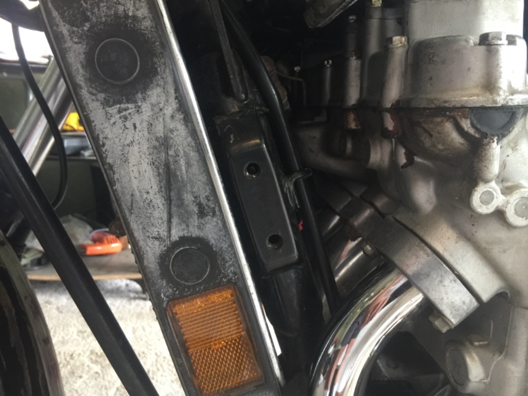

I screw in a bolt in the lower hole and attach a chain with a turnbuckle down to my lift. Rock solid.
