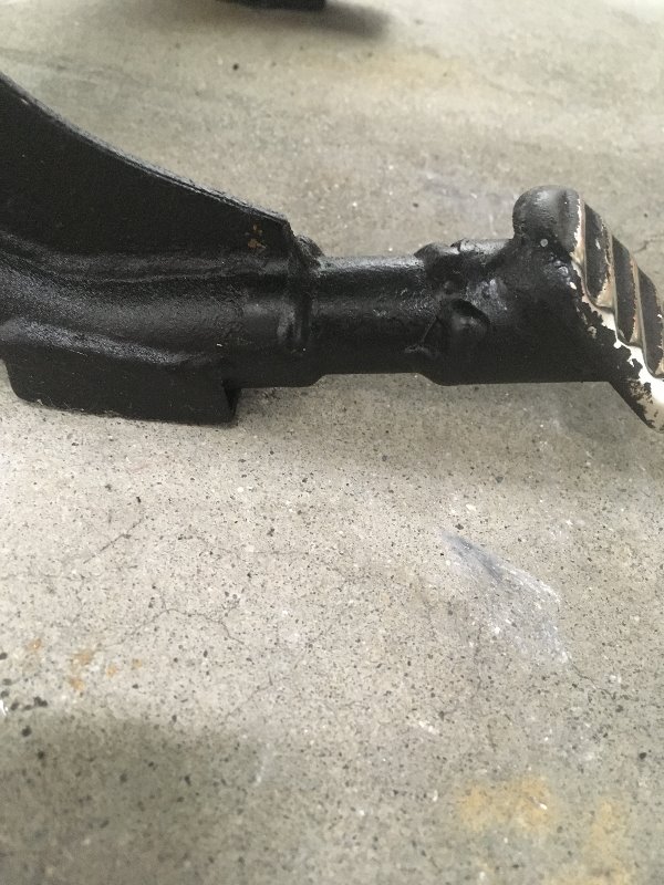

Kawboy wrote: [quote="Kawboy" post=28373]If you have 40 psi in the rear then the only other thing that comes to mind- How much air do you have in the front?
The "other thing" I should have added to this post yesterday is that you must have modified the center stand to accommodate the DG exhaust because the stock center stand will not work with the DG exhaust so what exactly did you do when you modified it? Did your mod lower the mount of the center stand causing your problem?[/quote]
The CS wasn't modified to fit the DG exhaust. The only addition is a bracket, to stop the CS from contacting the exhaust system when retracted.

scotch wrote: Or.....You can shorten the C/S legs by 5/8" and add an extension to the toe-pad.
Ultimately, me thinks this is the answer. I have a good fab shop 20 miles away. Just may source a used centerstand and get to cutting and welding...
