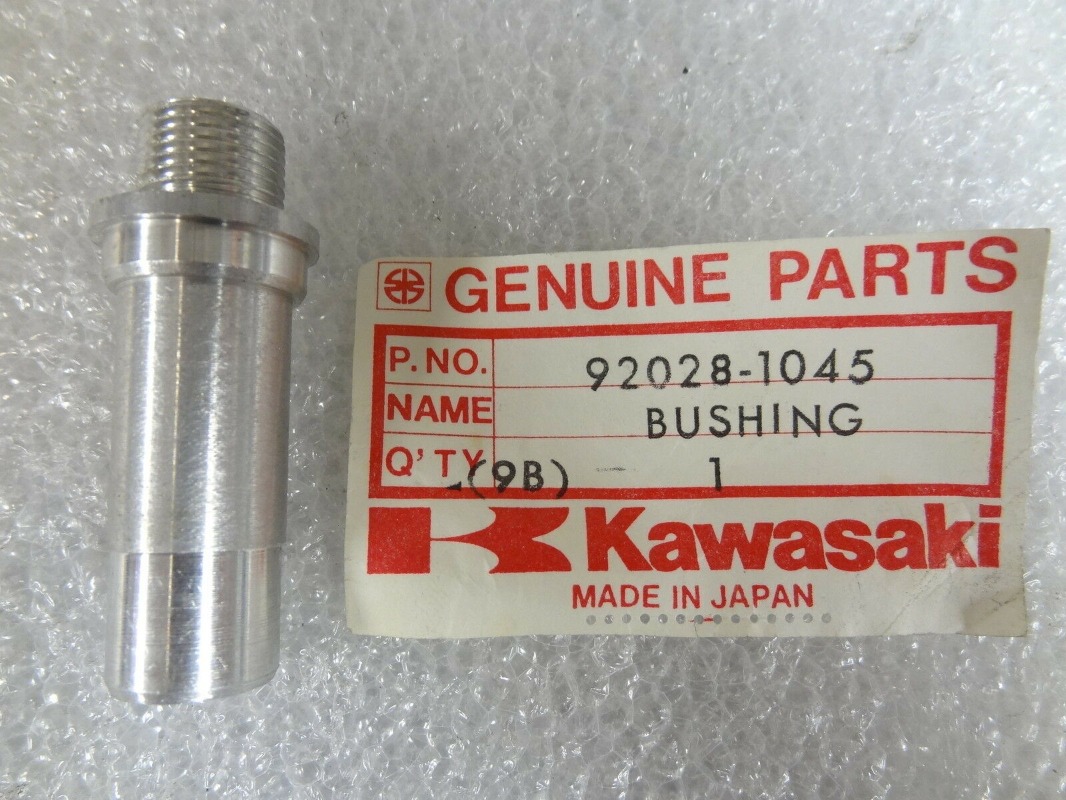

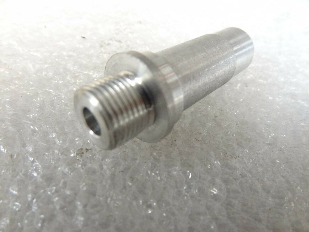

Hi Bill,
There just happens to be 1 for sale on EBay with a couple of great pictures. Looks like it's threaded in with a right hand thread. See pics. I would suggest a little heat and a light grip with ( i hate to say it) vice grips will probably get it out.

Thanks for bringing the above pics to my attention Kawboy. They show how I might run a nut onto the thread and draw the shank out using that nut. regards

I did run a nut over the thread which incidentally was 12mm x 1mm pitch and was able to draw out the shank easily with no damage to the soft thread.
